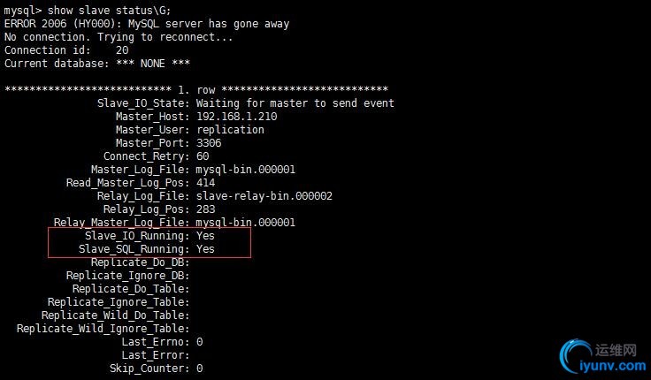

step6:分别在master和slave上查看slave状态,验证是否成功配置主主复制模式
1、master
2、slave
slave状态同步过程可能需要重启MySQL服务
[iyunv@master ~]# service mysqld restart
[iyunv@slave ~]# service mysqld restart

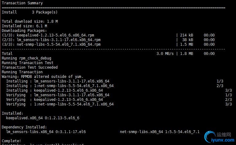

step1:安装keepalived
方法一:使用yum安装keepalived,需要安装epel-release源
[iyunv@master ~]# rpm -ivh http://mirrors.opencas.cn/epel/6/i386/epel-release-6-8.noarch.rpm
[iyunv@slave ~]# rpm -ivh http://mirrors.opencas.cn/epel/6/i386/epel-release-6-8.noarch.rpm
[iyunv@slave ~]# yum -y install keepalived

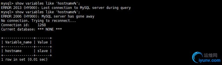

2、故障测试,停止master的MySQL服务,再次查看是否转移至slave服务器上
[iyunv@master ~]# service mysqld stop
Shutting down MySQL.... SUCCESS!
9
10
11
12
13
14
mysql> show variables like 'hostname%';
ERROR 2013 (HY000): Lost connection to MySQL server during query
ERROR 2006 (HY000): MySQL server has gone away
No connection. Trying to reconnect...
Connection id:    1268
Current database: *** NONE ***
| Variable_name | Value |
| hostname      | slave |
1 row in set (0.01 sec)
由测试结果可以看出,keepalived成功转移MySQL服务
