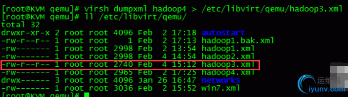

2,克隆hadoop4.xml文件
9
10
11
[iyunv@KVM qemu]# virsh dumpxml hadoop4 > /etc/libvirt/qemu/hadoop3.xml
[iyunv@KVM qemu]# ll /etc/libvirt/qemu/
total 32
drwxr-xr-x 2 root root 4096 Feb  2 17:18 autostart
-rw-r--r-- 1 root root    1 Feb  2 17:13 hadoop1.bak.xml
-rw------- 1 root root 2998 Feb  2 13:54 hadoop1.xml
-rw------- 1 root root 2998 Feb  4 14:54 hadoop2.xml
-rw-r--r-- 1 root root 2740 Feb  4 15:12 hadoop3.xml
-rw------- 1 root root 2965 Feb  2 17:25 hadoop4.xml
drwx------ 3 root root 4096 Jan 26 16:47 networks
-rw------- 1 root root 3036 Feb  2 15:52 win7.xml
QQ截图20160215143207.png 3,复制kvm虚拟机磁盘文件,该磁盘文件的路径也可以通过配置文件xml, <source file='/images/test/hadoop4.img'/>路径进行查看

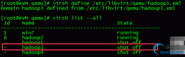

4,重新定义新虚拟机的配置文件
9
10
[iyunv@KVM qemu]# virsh define /etc/libvirt/qemu/hadoop3.xml
Domain hadoop3 defined from /etc/libvirt/qemu/hadoop3.xml
[iyunv@KVM qemu]# virsh list --all
Id    Name                           State
1     win7                           running
6     hadoop2                        running
-     hadoop1                        shut off
-     hadoop3                        shut off
-     hadoop4                        shut off
