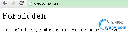

六、定义虚拟主机的访问权限,让192.168.75.1无法访问www.a.com
# vim virtual_host.conf
#基于域名的的虚拟主机
NameVirtualHost 192.168.75.131:80
<VirtualHost 192.168.75.131:80>
ServerName www.a.com
DocumentRoot "/www/a.com"
ServerAlias a.com
ErrorLog "logs/a.com-error_log"
CustomLog "logs/a.com-access_log" common
<Directory "/www/a.com">
Options none
AllowOverride none
Order deny,allow
Deny from 192.168.75.1
</Directory>
</VirtualHost>
DocumentRoot "/www/b.com"
ServerName www.b.com
ServerAlias b.com
ErrorLog "logs/b.com-error_log"
CustomLog "logs/b.com-access_log" common
</VirtualHost>
#httpd -t
Syntax OK
# /etc/init.d/httpd restart
Stopping httpd:                                            [  OK  ]
Starting httpd:                                            [  OK  ]
客户端192.168.75.1访问:
http://www.a.com/  #不能访问
http://www.b.com/
