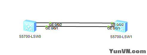

实验之一:链路聚合
华为S5700交换机两台,拓扑图如下:
在A交换机做如下配置
[A]interface Eth-Trunk 0
[A-Eth-Trunk0]
将A交互垃圾需要聚合的端口加入到Eth-Trunk 0中
[A]interface g0/0/1
[A-GigabitEthernet0/0/1]e
[A-GigabitEthernet0/0/1]eth-trunk 0
Info: This operation may take a few seconds. Please wait for a moment...done.
[A]interface g0/0/2
[A-GigabitEthernet0/0/2]eth-trunk 0
[A]dis eth-trunk 0
Eth-Trunk0's state information is:
WorkingMode: NORMAL         Hash arithmetic: According to SIP-XOR-DIP
Least Active-linknumber: 1  Max Bandwidth-affected-linknumber: 8
Operate status: up          Number Of Up Port In Trunk: 2
PortName                      Status      Weight
GigabitEthernet0/0/1          Up          1
GigabitEthernet0/0/2          Up          1
[A]
在B交换机上进行如下配置
[B]interface Eth-Trunk 0
[B-Eth-Trunk0]quit
[B]
将B交换机需要聚合的端口加入到Eth-Trunk 0中
[B]int g0/0/1
[B-GigabitEthernet0/0/1]e
[B-GigabitEthernet0/0/1]eth-trunk 0
[B-GigabitEthernet0/0/2]eth-trunk 0
[B]dis eth-trunk 0
[B]
以上就是配置链路聚合的简单步骤,希望对大家有用!!shxke希望大家多多交流我网络方面的知识!!
