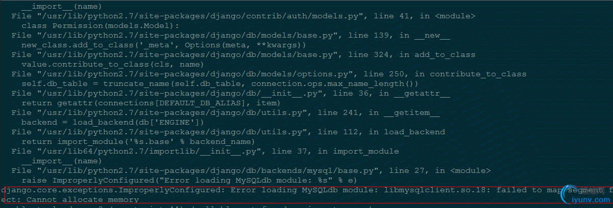

2.日志报错
解决方法
修改uwsgi参数 limit-as =512

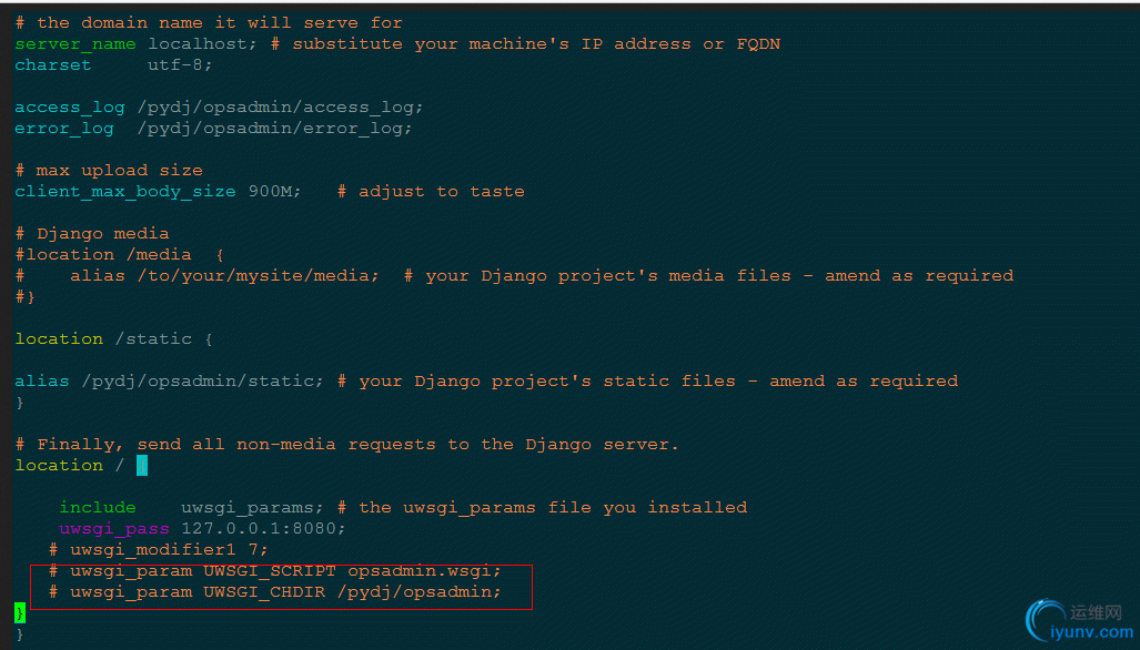

33
34
django-nginx.conf
# the port your site will be served on
listen     8000;
# the domain name it will serve for
server_name localhost; # substitute yourmachine's IP address or FQDN
charset    utf-8;
access_log /pydj/opsadmin/access_log;
error_log /pydj/opsadmin/error_log;
# max upload size
client_max_body_size 900M;   # adjust to taste
# Django media
#location /media  {
#   alias /to/your/mysite/media;  #your Django project's media files - amend as required
location /static {
alias /pydj/opsadmin/static; # your Djangoproject's static files - amend as required
# Finally, send all non-media requests tothe Django server.
location / {
   include    uwsgi_params; # theuwsgi_params file you installed
   uwsgi_pass 127.0.0.1:8080;
   #uwsgi_modifier1 7;
   uwsgi_param UWSGI_SCRIPT opsadmin.wsgi;
uwsgi_paramUWSGI_CHDIR /pydj/opsadmin;
nginx与uwsgi通信
uwsgi_pass 127.0.0.1:8080  #nginx
socket = 127.0.0.1:8080    #uwsgi
