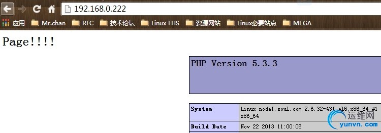

一切准备就绪后;下面就是配置资源了,最繁琐的也是这里
三、配置高可用集群资源
首先做个简单的规划;需要配置哪些资源,先后次序后续启动时很重要的:
1、配置VIP
2、配置NFS共享存储
3、配置httpd服务
4、配置mysql服务
5、配置一个资源组;把上述资源加入该组
所需要的命令或需要使用的代理大致:
#资源类型:
crm(live)# ra
crm(live)ra# classes
lsb
ocf / heartbeat pacemaker
service
stonith
crm(live)ra#
#资源代理,可以此类推查看
crm(live)ra# list lsb
NetworkManager    abrt-ccpp         abrt-oops         abrtd             acpid
atd               auditd            autofs            blk-availability  bluetooth
corosync          corosync-notifyd  cpuspeed          crond             cups
dnsmasq           firstboot         haldaemon         halt              htcacheclean
httpd             ip6tables         iptables          irqbalance        kdump
killall           libvirt-guests    lvm2-lvmetad      lvm2-monitor      mdmonitor
messagebus        mysqld            netconsole        netfs             network
nfs               nfslock           ntpd              ntpdate           pacemaker
php-fpm           portreserve       postfix           psacct            quota_nld
rdisc             restorecond       rngd              rpcbind           rpcgssd
rpcidmapd         rpcsvcgssd        rsyslog           sandbox           saslauthd
single            smartd            spice-vdagentd    sshd              svnserve
sysstat           udev-post         wdaemon           winbind           wpa_supplicant
#详细信息
crm(live)ra# info lsb:nfs
lsb:nfs
NFS is a popular protocol for file sharing across networks.
               This service provides NFS server functionality, which is \
               configured via the /etc/exports file.
Operations' defaults (advisory minimum):
    start         timeout=15
    stop          timeout=15
    status        timeout=15
    restart       timeout=15
    force-reload  timeout=15
    monitor       timeout=15 interval=15
大致了解后,添加资源:
#首先配置几个全局属性信息
#禁用stonith设备,因为这里没有该设备可以使用
crm(live)configure# property stonith-enabled=false
crm(live)configure# verify    #校验下
#忽略不满足法定票数时的操作
crm(live)configure# property no-quorum-policy=ignore
crm(live)configure# commit     #确认后提交
#查看配置的信息
crm(live)configure# show
node node1.soul.com
node node2.soul.com
property $id="cib-bootstrap-options" \
    dc-version="1.1.10-14.el6-368c726" \
    cluster-infrastructure="classic openais (with plugin)" \
    expected-quorum-votes="2" \
    stonith-enabled="false" \
    no-quorum-policy="ignore"
配置VIP
crm(live)configure# primitive webip ocf:heartbeat:IPaddr params ip=192.168.0.222 op monitor interval=30s timeout=30s on-fail=restart
#参数可以help查看
node node1.soul.com
node node2.soul.com
primitive webip ocf:heartbeat:IPaddr \
    params ip="192.168.0.222" \
    op monitor interval="30s" timeout="30s" on-fail="restart"
#commit后就可以查看状态信息
crm(live)# status
Last updated: Wed Apr 23 12:26:20 2014
Last change: Wed Apr 23 12:25:22 2014 via cibadmin on node1.soul.com
Stack: classic openais (with plugin)
Current DC: node2.soul.com - partition with quorum

#可以看出都运行在node1上,然后更改下node1的httpd的配置文件
#更改对应的网页目录到NFS下的/share/www
#在到/share/www创建一个文件进行测试
[iyunv@node1 www]# vim /share/www/index.php
<h1>Page!!!!</h1>
<?php
        phpinfo();
#保存测试
测试访问正常。可以安装论坛测试

#查看全部转移到node2上
#刷新网页查看下
测试一切正常;到此;LAMP的高可用已配置完成。如有问题;可以留言讨论。
