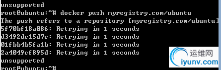

问题回顾周末的时候,有个朋友在搭建docker registry v2版本(http://dockone.io/article/845)的时候遇到了一个问题:
问题描述:仓库搭建完成后,login没问题,但是push镜像会一直在retry,直到超时。 da7d8411c2061a32065b7d2040bce1e5.jpg
1:docker push myregistry.com/ubuntu:0.0.1The push refers to a repository [myregistry.com/ubuntu]
xxxxxxx: Retrying in 5 seconds
unsupported
log:
time="2016-02-27T07:43:30Z" level=warning msg="error authorizing context: authorization token required" go.version=go1.5.3 http.request.host=myregistry.com http.request.id=cf177681-c67a-4ecf-ad9c-7055faaf3331 http.request.method=GET http.request.remoteaddr="192.168.159.136:51585" http.request.uri="/v2/" http.request.useragent="docker/1.10.2 go/go1.5.3 git-commit/c3959b1 kernel/3.13.0-24-generic os/linux arch/amd64" instance.id=b498d7d9-aaa1-4a16-9fb6-714447085964 version=v2.3.0
192.168.159.136 - - [27/Feb/2016:07:43:30  0000] "GET /v2/ HTTP/1.1" 401 87 "" "docker/1.10.2 go/go1.5.3 git-commit/c3959b1 kernel/3.13.0-24-generic os/linux arch/amd64"time="2016-02-27T07:43:30Z" level=error msg="response completed with error" auth.user.name=admin err.code=unsupported err.message="The operation is unsupported." go.version=go1.5.3 http.request.host=myregistry.com http.request.id=4a12623f-b8f4-4875-95ba-115eb375f6d5 http.request.method=POST http.request.remoteaddr="192.168.159.136:51587" http.request.uri="/v2/ubuntu/blobs/uploads/" http.request.useragent="docker/1.10.2 go/go1.5.3 git-commit/c3959b1 kernel/3.13.0-24-generic os/linux arch/amd64" http.response.contenttype="application/json; charset=utf-8" http.response.duration=4.218218ms http.response.status=405 http.response.written=78 instance.id=b498d7d9-aaa1-4a16-9fb6-714447085964 vars.name=ubuntu version=v2.3.0
192.168.159.136 - - [27/Feb/2016:07:43:30  0000] "POST /v2/ubuntu/blobs/uploads/ HTTP/1.1" 405 78 "" "docker/1.10.2 go/go1.5.3 git-commit/c3959b1 kernel/3.13.0-24-generic os/linux arch/amd64"time="2016-02-27T07:43:30Z" level=error msg="response completed with error" auth.user.name=admin err.code=unsupported err.message="The operation is unsupported." go.version=go1.5.3 http.request.host=myregistry.com http.request.id=4c4fc4a9-9cdb-4ab7-a338-40d9da414dcf http.request.method=POST http.request.remoteaddr="192.168.159.136:51588" http.request.uri="/v2/ubuntu/blobs/uploads/" http.request.useragent="docker/1.10.2 go/go1.5.3 git-commit/c3959b1 kernel/3.13.0-24-generic os/linux arch/amd64" http.response.contenttype="application/json; charset=utf-8" http.response.duration=73.057308ms http.response.status=405 http.response.written=78 instance.id=b498d7d9-aaa1-4a16-9fb6-714447085964 vars.name=ubuntu version=v2.3.0
192.168.159.136 - - [27/Feb/2016:07:43:30  0000] "POST /v2/ubuntu/blobs/uploads/ HTTP/1.1" 405 78 "" "docker/1.10.2 go/go1.5.3 git-commit/c3959b1 kernel/3.13.0-24-generic os/linux arch/amd64"time="2016-02-27T07:43:30Z" level=error msg="response completed with error" auth.user.name=admin err.code=unsupported err.message="The operation is unsupported." go.version=go1.5.3 http.request.host=myregistry.com http.request.id=92c9c5bd-8281-441f-a745-4dadc3e13693 http.request.method=POST http.request.remoteaddr="192.168.159.136:51590" http.request.uri="/v2/ubuntu/blobs/uploads/" http.request.useragent="docker/1.10.2 go/go1.5.3 git-commit/c3959b1 kernel/3.13.0-24-generic os/linux arch/amd64" http.response.contenttype="application/json; charset=utf-8" http.response.duration=66.338973ms http.response.status=405 http.response.written=78 instance.id=b498d7d9-aaa1-4a16-9fb6-714447085964 vars.name=ubuntu version=v2.3.0
192.168.159.136 - - [27/Feb/2016:07:43:30  0000] "POST /v2/ubuntu/blobs/uploads/ HTTP/1.1" 405 78 "" "docker/1.10.2 go/go1.5.3 git-commit/c3959b1 kernel/3.13.0-24-generic os/linux arch/amd64"time="2016-02-27T07:43:30Z" level=error msg="response completed with error" auth.user.name=admin err.code=unsupported err.message="The operation is unsupported." go.version=go1.5.3 http.request.host=myregistry.com http.request.id=25cf49b8-99df-4d50-9f78-5ccc5d9e4bfc http.request.method=POST http.request.remoteaddr="192.168.159.136:51589" http.request.uri="/v2/ubuntu/blobs/uploads/" http.request.useragent="docker/1.10.2 go/go1.5.3 git-commit/c3959b1 kernel/3.13.0-24-generic os/linux arch/amd64" http.response.contenttype="application/json; charset=utf-8" http.response.duration=8.280863ms http.response.status=405 http.response.written=78 instance.id=b498d7d9-aaa1-4a16-9fb6-714447085964 vars.name=ubuntu version=v2.3.0

过程
分析
1、大致问了下,如果不加认证,push是没有问题的,所以先确定了裸registry是没有问题的;
2、看了下参数,似乎没什么特别的配置,觉得应该不会有啥问题(好尴尬);
3、看了下push的时候的报错是个unsupported,好吧,报错的似乎不知道为啥,像是异常没获取到,来了个通量的;
4、看了下日志,这算是一套push(认证 push)完整的流程,但是出现了"405 78" 的状态,405权限问题,似乎有点头绪了(这里被这种报错误影响了好久好久);
备注:auth server 可以参考开头的连接中博客的认证服务,用的就是那个
实验1
好了,405是个突破口了,似乎说明auth server那里出了点状况,
1、于是乎手动调取了下auth server的API,token是可以拿到的,ok,auth server最起码是理人的;
2、405权限呐,于是对着auth server的ACL文件是配了又配:
①:确定是否能用,我把admin的密码改了,然后docker login 不进去,确保能读取config
②:翻了下它的github,配置没有问题呀,这里的测试过程省略1W字。
在这个地方一筹莫展,然后就去打LOL了,悲伤的时候必须缓解下。
实验2
好了,队友挂机,我又回来了。又把过程想了下,docker 既然可以给我报错"unsupport",也许405也是错的呢。然后决定详细排查下启动参数:
1、按照不加任何参数直接启动,push没问题,启动也没问题;
2、发现"STANDALONE"/"REGISTRY_PROXY_REMOTEURL"这2个参数无法判断是否会影响;
3、加上token验证(只加了相关的参数),发现push没问题;
4、初步判断可能和"STANDALONE"/"REGISTRY_PROXY_REMOTEURL"这2个参数有关;
5、最后确认和REGISTRY_PROXY_REMOTEURL有关
实验3
按照参数的解释STANDALONE应该是索引index的开关,但是貌似不会有太大关系,先忽略掉了(大家可以搜下这个参数的具体解释,个人觉得这个参数在这里不影响(应该关掉false));
参数REGISTRY_PROXY_REMOTEURL意思是mirror模式,具体配置的为远程docker仓库,突然察觉到点什么:mirror模式下,docker仓库在pull的时候会去验证远端HUB是否有相应的镜像,然后缓存,难道push的时候也会?

这里只截取了一小段代码,这里大概的意思是push的时候,会去对比远端HUB是否有重复的layers。
因为设置参数的时候没有加相应的用户名密码(这里在官方文档中是确切要求必须添加用户名密码的https://docs.docker.com/registry/mirror/),所以造成了这个过程一直在retry。然后是docker在这一块处理的时候存在点问题,1是命令行抛了个"unsupported"报错,2是log中405报错有点尴尬,现在可以理解成到远端仓库中权限不足,但是log中不是很明确,似乎处理逻辑有些问题。
