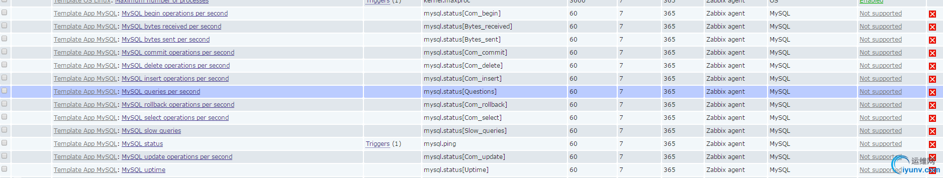

zabbix web上是这样
这个问题在百度google找了好久 都没解决,请问有人能帮我看下吗?线上等帮助 谢谢

查了下zabbix_server.log:
25055:20160308:145422.605 item "Zabbix server:mysql.ping" became not supported: Received value [^Gmysqladmin: connect to server at 'localhost' failederror: 'Can't connect to local MySQL server through socket '/tmp/mysql.sock' (2)'Check that mysqld is running and that the socket: '/tmp/mysql.sock' exists!] is not suitable for value type [Numeric (unsigned)] and data type [Decimal]
这是昨天14点54分22秒的事件吗?  我本地执行mysqladmin的命令是可以获取的到数据的呀

    现在看zabbix_server.log的最后日志是这样:
    24098:20160309:152747.743 error reason for "java.com:mysql.status[Questions]" changed: Received value [Warning: Using a password on the command line interface can be insecure.243847] is not suitable for value type [Numeric (float)]
    24098:20160309:152747.743 error reason for "java.com:mysql.status[Slow_queries]" changed: Received value [Warning: Using a password on the command line interface can be insecure.55751] is not suitable for value type [Numeric (unsigned)] and data type [Decimal]
    24098:20160309:152747.743 error reason for "java.com:mysql.status[Uptime]" changed: Received value [Warning: Using a password on the command line interface can be insecure.89002] is not suitable for value type [Numeric (unsigned)] and data type [Decimal]
