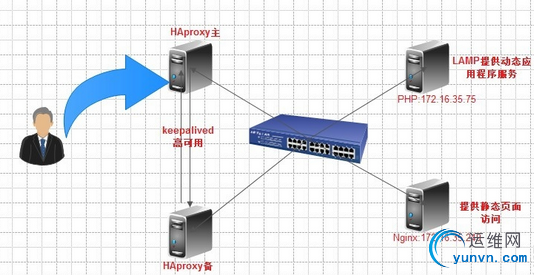

实验环境:
   Haproxy主:172.16.35.81
   Haproxy备:172.16.35.206
   PHP:172.16.35.75
   Nginx:172.16.35.249
   VIP:172.16.35.211
实验拓扑如下:

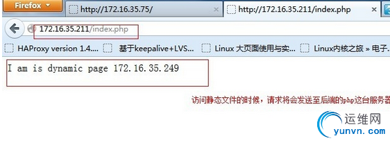

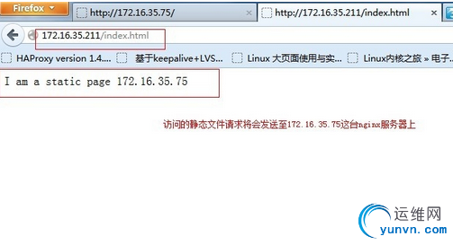

验证其结果是否实现动静分离:
