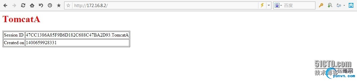

启动测试:

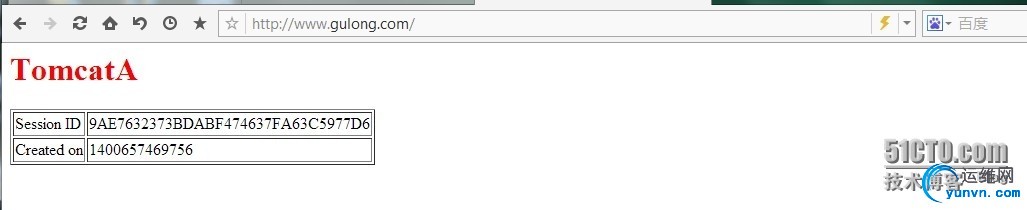

  • 重启httpd,测试
[iyunv@localhost ~]# service httpd restart
wKioL1N8VuTjUDJsAADcNaPrTiI601.jpg wKiom1N8Vy7CnZ8AAADqsFNhAzA121.jpg 从图看出,负载均衡已经实验成功(注:如果要用域名访问,在hosts文件中写入 172.16.8.2 www.gulong.com

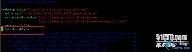

(2).修改web.xml
tomcatA:
[iyunv@node1 ~]# cd /web/webapp/
[iyunv@node1 webapp]# ls
index.jsp
[iyunv@node1 webapp]# mkdir WEB-INF
index.jsp WEB-INF
[iyunv@node1 webapp]# cp /usr/local/tomcat/conf/web.xml WEB-INF/
[iyunv@node1 ~]# vim /usr/local/tomcat/conf/web.xml
tomcatB:
[iyunv@localhost ~]# cd /web/webapp/
[iyunv@localhost webapp]# ls
index.jsp
[iyunv@localhost webapp]# mkdir WEB-INF
index.jsp WEB-INF
[iyunv@localhost webapp]# cp /usr/local/tomcat/conf/web.xml WEB-INF/
[iyunv@localhost ~]# vim /usr/local/tomcat/conf/web.xml
