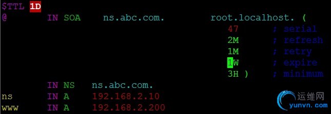

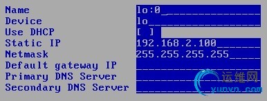

DNS-Master及DNS-Backup安装bind
9
# yum install bind bind-chroot
# vim /etc/sysctl.conf                  //添加以下两行
net.ipv4.conf.all.arp_announce = 2
net.ipv4.conf.all.arp_ignore = 1
# sysctl -p
# ll slaves/
-rw-r-----. 1 root named 186 May 27 06:06 abc.com.local
-rw-r-----. 1 root named 229 May 27 06:06 abc.com.zone

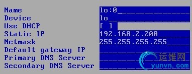

# yum install httpd
# echo "This is web1.">/var/www/html/index.html
# sysctl -p

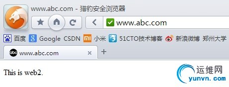

客户端测试:
客户端IP配置:
客户端浏览器访问http://www.abc.com,并不断刷新。
