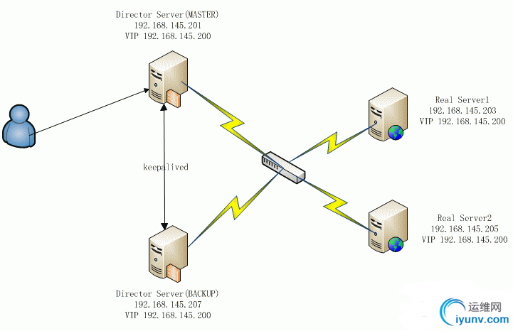

二、lvs+keepalived实现高可用集群:
lvs+keepalived高可用集群拓扑图
Director Server中需安装keepalived软件,并进行如下配置:
