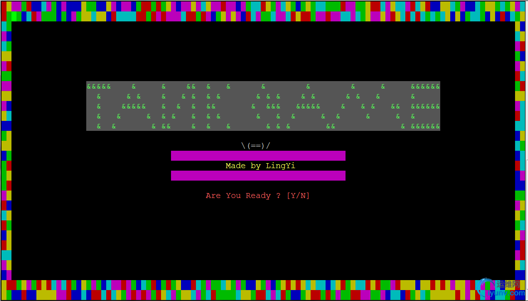

一个游戏不管好不好,开始界面一定不能太挫
不要以为这是静态的,会动的。。。。
代码:

DisFrame()
    stop=false
    trap "stop=true" 10
    while ! $stop
    do
        for ((i=1; i<=cols;    i++)); do
            echo -ne "[1;${i}H[4$((RANDOM%6+1))m "
        done
        for ((i=2; i<=lines;   i++)); do
            echo -ne "[${i};${cols}H[4$((RANDOM%6+1))m "
        done
        for ((i=cols-1; i>=1 ; i--)); do
            echo -ne "[${lines};${i}H[4$((RANDOM%6+1))m "
        done
        for ((i=lines-1; i>=2; i--)); do
            echo -ne "[${i};1H[4$((RANDOM%6+1))m "
        done
        for ((i=2; i<=cols-1;  i++)); do
            echo -ne "[2;${i}H[4$((RANDOM%6+1))m "
        done
        for ((i=2; i<=lines-1; i++)); do
            echo -ne "[${i};$[cols-1]H[4$((RANDOM%6+1))m "
        done
        for ((i=cols-2; i>=2;  i--)); do
            echo -ne "[$[lines-1];${i}H[4$((RANDOM%6+1))m "
        done
        for ((i=lines-2; i>=2; i--)); do
            echo -ne "[${i};2H[4$((RANDOM%6+1))m "
        done
        sleep 0.1
    done
# $0 char sleep_time start_line end_line start_col  upper/low  upper/low  left/right
PrintChar2(){
    aa='echo -ne "[${i};${5}H[1;${6}m$1"; sleep $2'
    bb='[[ $i -ne $4 ]] && echo -ne "[${i};${5}H[1;${6}m "'
    if [[ ${8} == "left" ]]; then
        [[ ${7} == "upper" ]] && for((i=$3; i<=$4; i++)); do eval "$aa; $bb"; done
        [[ ${7} == "low"   ]] && for((i=$3; i>=$4; i--)); do eval "$aa; $bb"; done
    fi
cols=`tput cols`
lines=`tput lines`
clear
DisFrame &
DisFramePid=$!
#DisSymbol $[lines/2-6] $[cols/2-34] 32
a='&&&&&    &     &    &&  &   &      &        &        &     &     &&&&&&'
b='  &     & &    &   & &  & &       & & &    & &      & &   &      &     '
c='  &    &&&&&   &  &  &  &&       &  &&&   &&&&&    &   & &   &&  &&&&&&'
d='  &   &     &  & &   &  & &       &   &  &     &  &     &     &  &     '
e='  &  &       & &&    &  &   &       & & &       &&             & &&&&&&'
abcde=(a b c d e)
for((i=0; i<5; i++)); do
    eval echo -ne "\"[$(($[lines/2-6]+$i));$[cols/2-34]H$${abcde}\""
    sleep 0.1
done
echo -ne "[$[lines/2];$[cols/2-3]H(==)/"
i=1
col=$[cols/2-17]
while [[ $i -le 35 ]]; do
    echo -ne "[$[lines/2+1];${col}H e[0m"
    echo -ne "[$[lines/2+3];${col}H e[0m"
    sleep 0
    (( i+=1 ))
    (( col+=1 ))
done
strings="Made by LingYi"
col=$[cols/2-6]
for ((a=0;a<=${#strings}-1;a++)); do
    for((i=$[cols-2]; i>=$col; i--)); do
        echo -ne "[$[lines/2+2];${i}H${strings:a:1}"
        [[ $i -ne $col ]] && echo -ne "[$[lines/2+2];${i}H[1;$33m "
    done
    let col++
done
strings='Are You Ready ? [Y/N]'
col=$[cols/2-10]
    [[ $[RANDOM%2] -eq 0 ]] && {
        PrintChar2 "${strings:a:1}" 0 $[lines/2+4] $[lines/2+5] $col  31 upper left
    } || PrintChar2 "${strings:a:1}" 0 $[lines-2] $[lines/2+5] $col  31 low left
    let col++
done
while :; do
    echo "ynq" | grep -q ${ch:-H} && {
        kill -10 ${DisFramePid} &>/dev/null
        break
    echo -ne "[$[lines/2+5];$[cols/2-10]HAre You Ready ? [Y/N]"
    read -s -n 1 ch
    ch=$(echo ${ch} | tr 'A-Z' 'a-z')
done

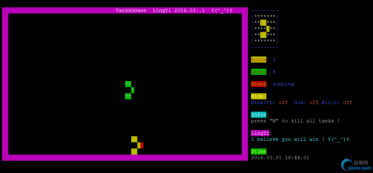

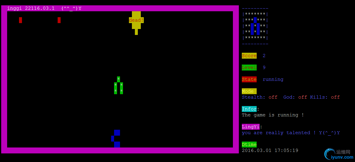

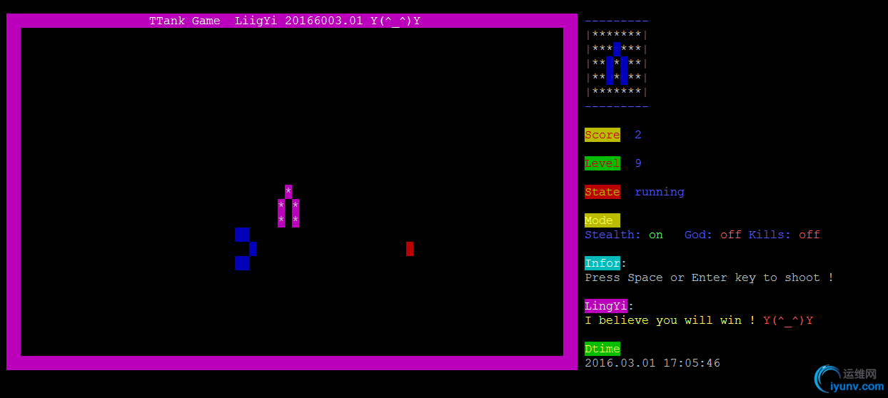

当然,游戏画面也得够炫
介绍下游戏里的功能和右侧各组件
实现的功能:
1、首先在定义的位置中随机显示敌方坦克(位置、方向、颜色皆是随机)
2、W、A、S、D 和上下左右按键实现玩家坦克移动
3、玩家坦克可使用空格、回车按键发射炮弹
4、“P”键暂停游戏,“C”键继续游戏
5、敌方坦克会在随机时刻发射炮弹
6、实现积分、自动升级等功能,并可以通过按键手动调节(U:升级 L:降级)。
各组件的功能:
1、游戏上方边界中的文字是滚动播放的
2、右侧显示的坦克模型为当下敌方坦克生成时的状态,随时更新
3、“Score”和“level” 显示分数和等级
4、“state”显示游戏的状态,有暂停、游戏中和游戏结束三种状态。
5、“Mode”显示的是坦克的状态(相应外挂是否开启)
6、“Infore”打印各种功能按键的介绍信息,随机时刻随机更新
7、“LingYi”有字符串和高效图标组成,随机时刻随机组合,颜色同样随机
8、“Dtime”显示当前日期和时间,1s更新一次

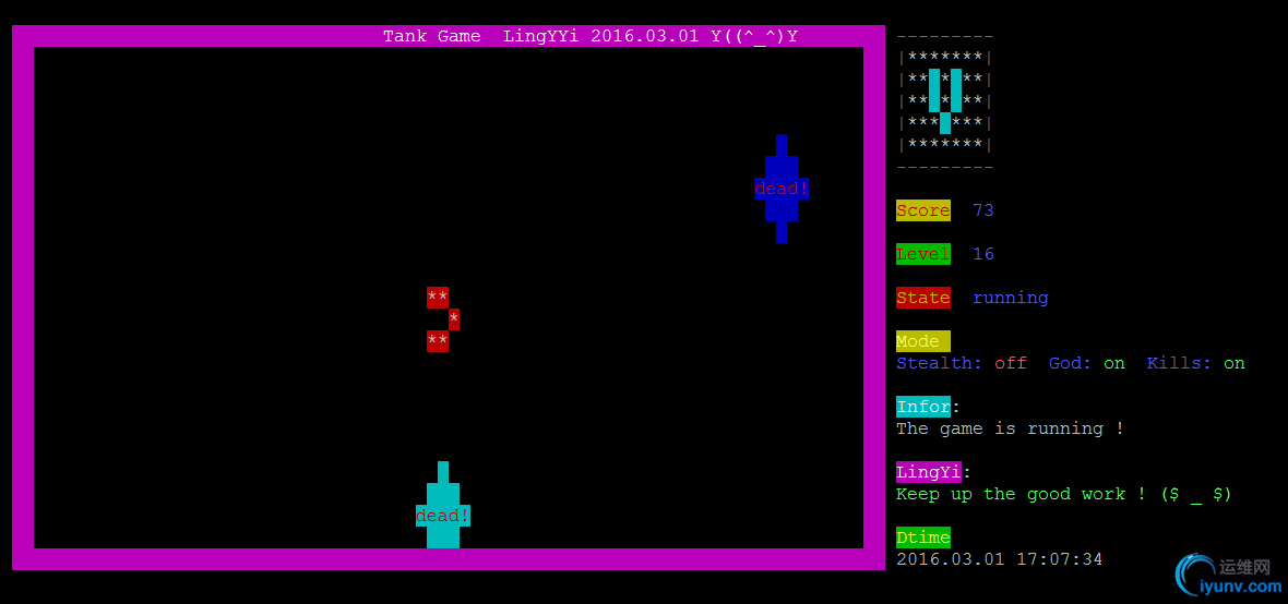

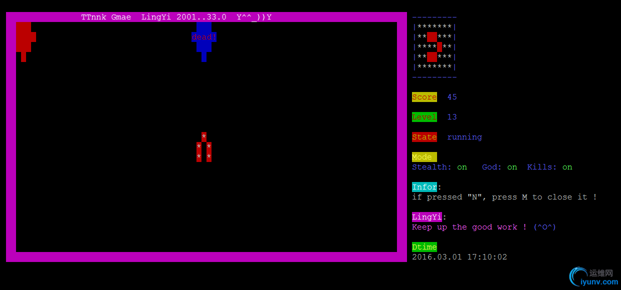

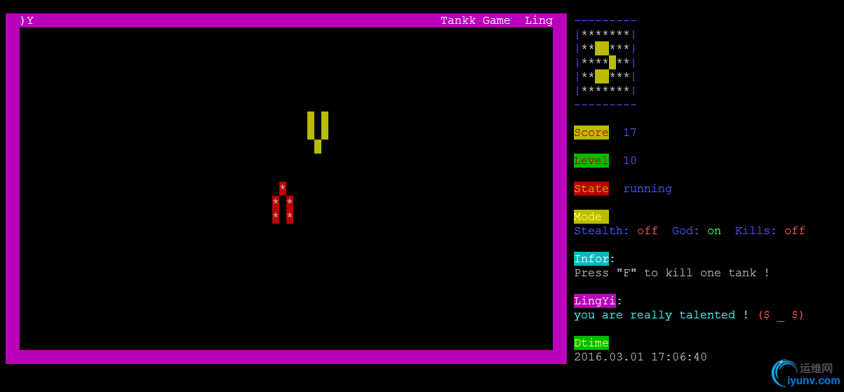

关于外挂(四种): ciya.gif
“F”键:当前敌方坦克自爆
“G”键:隐身模式,无视撞击和炮弹,开启后颜色变为游戏边界颜色(开启/关闭)
“V”键:上帝模式,相比隐身模式,开启后可通过撞击消灭敌方坦克,颜色变为红色(开启和关闭)
“N”键:KillS模式,满屏自爆,爽歪歪(开启)
“M”键:KillS模式(关闭)
注:上帝模式开启后,无视隐身模式,若后前先开启,则可同时开启。
三种模式可同时开启
