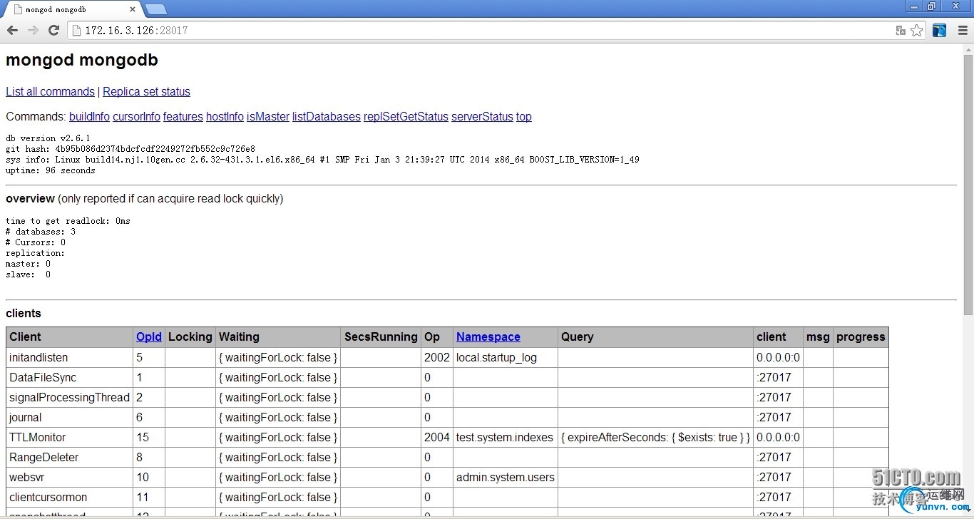

  • 一、介绍Mongodb的web管理界面
1、Mongodb的安装
2、启动Mongodb以及web管理端口
注释:截取一部分参数
9
10
11
12
13
14
15
16
17
18
19
20
21
22
23
24
[iyunv@mongodb ~]# mongod --help
Options:
General options:
  -f [ --config ] arg         configuration file specifying additional options
  --quiet                     quieter output
  --port arg                  specify port number - 27017 by default
  --dbpath arg (=/data/db)    directory for datafiles - defaults to /data/db/
  --logpath arg               log file to send write to instead of stdout - has
  --httpinterface             enable http interface
  --fork                      fork server process
  --rest                      turn on simple rest api
注意:默认情况下mongodb 2.6版本的管理关口是是关闭的
--httpinterface:启用mongodb的http的端口
[iyunv@mongodb ~]# mongod --httpinterface
2014-06-10T16:19:00.067-0400 [initandlisten] MongoDB starting : pid=6157 port=27017 dbpath=/data/db 64-bit host=mongodb
2014-06-10T16:19:00.068-0400 [initandlisten] db version v2.6.1
2014-06-10T16:19:00.068-0400 [initandlisten] git version: 4b95b086d2374bdcfcdf2249272fb552c9c726e8
2014-06-10T16:19:00.068-0400 [initandlisten] build info: Linux build14.nj1.10gen.cc 2.6.32-431.3.1.el6.x86_64 #1 SMP Fri Jan 3 21:39:27 UTC 2014 x86_64 BOOST_LIB_VERSION=1_49
2014-06-10T16:19:00.068-0400 [initandlisten] allocator: tcmalloc
2014-06-10T16:19:00.068-0400 [initandlisten] options: { net: { http: { enabled: true } } }
2014-06-10T16:19:00.198-0400 [initandlisten] journal dir=/data/db/journal
2014-06-10T16:19:00.198-0400 [initandlisten] recover : no journal files present, no recovery needed
2014-06-10T16:19:00.209-0400 [initandlisten] waiting for connections on port 27017
2014-06-10T16:19:00.252-0400 [websvr] admin web console waiting for connections on port 28017
3.访问Mongodb的管理界面 http://172.16.3.126:28017/ wKioL1OYNYGSZnpPAAX_UdIhiMQ834.jpg

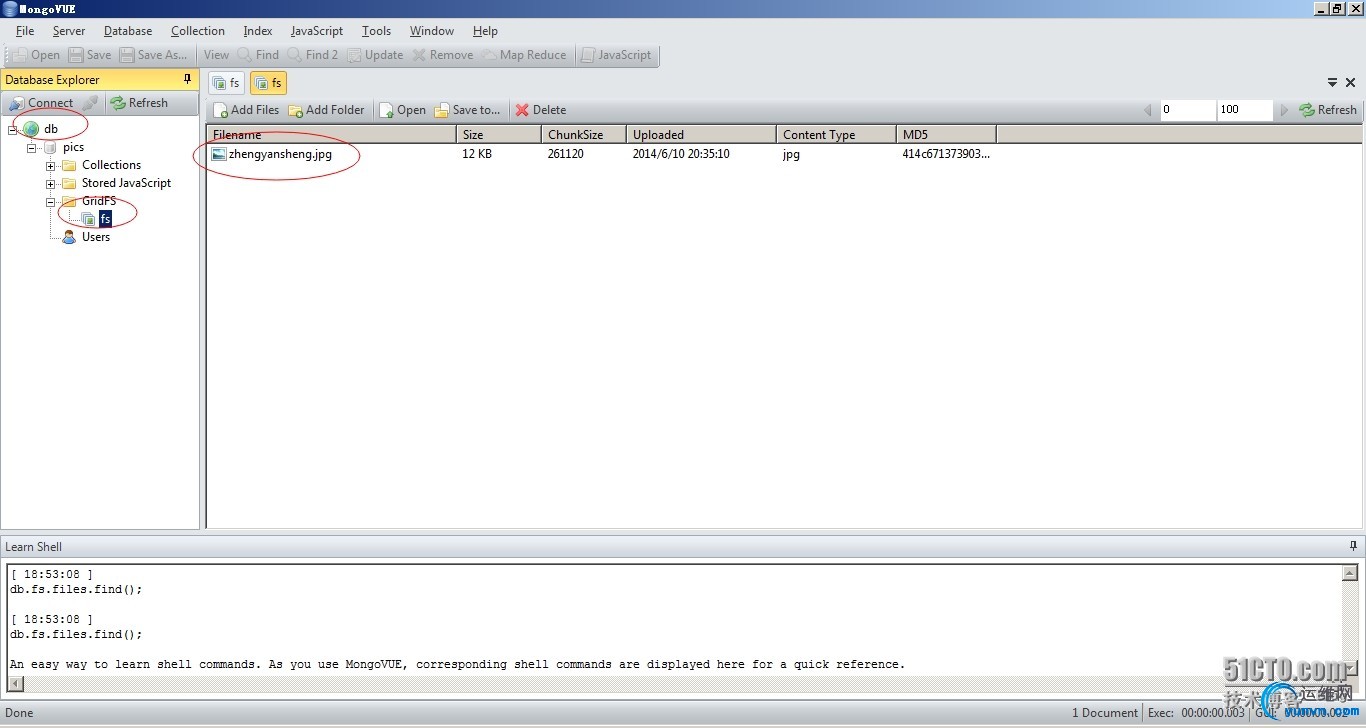

二、在Mongodb中存放文件有两种方式:
1、命令行方式mongofiles
#上传图片到mongodb数据库
9
10
11
12
13
14
15
16
17
[iyunv@mongodb opt]# mongofiles put zhengyansheng.jpg -h 127.0.0.1 -d pics -t jpg
connected to: 127.0.0.1
added file: { _id: ObjectId('53976bfee549115e4df63464'), filename: "zhengyansheng.jpg", chunkSize: 261120, uploadDate: new Date(1402432510426), md5: "414c671373903f8093acbace1ab35978", length: 12335, contentType: "jpg" }
done!
#查看mongodb是否有图片
MongoDB shell version: 2.6.1
connecting to: test
> use pics
switched to db pics
> show collections
fs.chunks
fs.files
system.indexes
> db.fs.files.find()
{ "_id" : ObjectId("53976bfee549115e4df63464"), "filename" : "zhengyansheng.jpg", "chunkSize" : 261120, "uploadDate" : ISODate("2014-06-10T20:35:10.426Z"), "md5" : "414c671373903f8093acbace1ab35978", "length" : 12335, "contentType" : "jpg" }

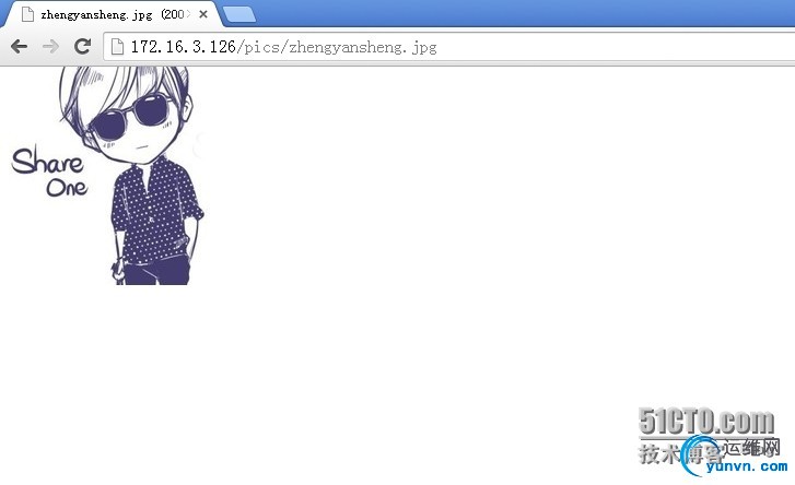

3、访问nginx中mongodb的图片资源
9
10
11
12
13
14
15
16
17
18
19
20
这里需要证明一个结论:就是Mongodb不缓存在客户端的浏览器中
做个试验来证明我的结论
首先我们来访问nginx的默认首页
访问:http://172.16.3.126/
[iyunv@mongodb ~]# tail -f /usr/local/nginx/logs/access.log
172.16.3.136 - - [10/Jun/2014:17:11:35 -0400] "GET / HTTP/1.1" 200 612 "-" "Mozilla/5.0 (Windows NT 6.1; WOW64) AppleWebKit/537.36 (KHTML, like Gecko) Chrome/34.0.1847.131 Safari/537.36" "-"
172.16.3.136 - - [10/Jun/2014:17:11:35 -0400] "GET /favicon.ico HTTP/1.1" 404 570 "-" "Mozilla/5.0 (Windows NT 6.1; WOW64) AppleWebKit/537.36 (KHTML, like Gecko) Chrome/34.0.1847.131 Safari/537.36" "-"
172.16.3.136 - - [10/Jun/2014:17:11:48 -0400] "GET / HTTP/1.1" 304 0 "-" "Mozilla/5.0 (Windows NT 6.1; WOW64) AppleWebKit/537.36 (KHTML, like Gecko) Chrome/34.0.1847.131 Safari/537.36" "-"
172.16.3.136 - - [10/Jun/2014:17:11:51 -0400] "GET / HTTP/1.1" 304 0 "-" "Mozilla/5.0 (Windows NT 6.1; WOW64) AppleWebKit/537.36 (KHTML, like Gecko) Chrome/34.0.1847.131 Safari/537.36" "-"
172.16.3.136 - - [10/Jun/2014:17:11:56 -0400] "GET / HTTP/1.1" 304 0 "-" "Mozilla/5.0 (Windows NT 6.1; WOW64) AppleWebKit/537.36 (KHTML, like Gecko) Chrome/34.0.1847.131 Safari/537.36" "-"
再次访问mongodb
访问:http://172.16.3.126/pics/zhengyansheng.jpg
172.16.3.136 - - [10/Jun/2014:17:12:40 -0400] "GET /pics/zhengyansheng.jpg HTTP/1.1" 200 12335 "-" "Mozilla/5.0 (Windows NT 6.1; WOW64) AppleWebKit/537.36 (KHTML, like Gecko) Chrome/34.0.1847.131 Safari/537.36" "-"
172.16.3.136 - - [10/Jun/2014:17:12:40 -0400] "GET /favicon.ico HTTP/1.1" 404 570 "-" "Mozilla/5.0 (Windows NT 6.1; WOW64) AppleWebKit/537.36 (KHTML, like Gecko) Chrome/34.0.1847.131 Safari/537.36" "-"
172.16.3.136 - - [10/Jun/2014:17:12:55 -0400] "GET /pics/zhengyansheng.jpg HTTP/1.1" 200 12335 "-" "Mozilla/5.0 (Windows NT 6.1; WOW64) AppleWebKit/537.36 (KHTML, like Gecko) Chrome/34.0.1847.131 Safari/537.36" "-"
172.16.3.136 - - [10/Jun/2014:17:12:58 -0400] "GET /pics/zhengyansheng.jpg HTTP/1.1" 200 12335 "-" "Mozilla/5.0 (Windows NT 6.1; WOW64) AppleWebKit/537.36 (KHTML, like Gecko) Chrome/34.0.1847.131 Safari/537.36" "-"
大家注意看状态码会发现,当我们访问nginx的默认首页的时候状态码是200-->304-->304-->304  说明从浏览器取的缓存
                        当我们访问mongodb的时候状态吗是200-->200-->200-->200    说明每次都是从服务器取的资源
