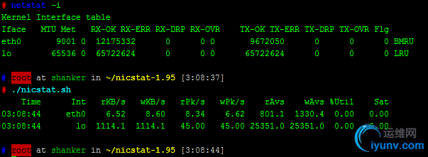

nicstat对于分析网络接口的方法类似于iostat分析磁盘使用率,或者说类似于prstat分析进程信息,它比netstat -i更高级的地方在于:可以输出网卡速率,read/write 使用率,网卡的TCP, UDP信息。有人说那还不如用iptraf或者iftop呢,不一样都能查看网卡速率吗?nicstat强大的地方是可以以iostat的方式直接输出网卡使用率,而iftop,iptraf 只能跟踪单个网卡信息。
可以对比一下netstat -i 和 nicstat的输出数据:
显而易见,nicstat的输出更人性化。

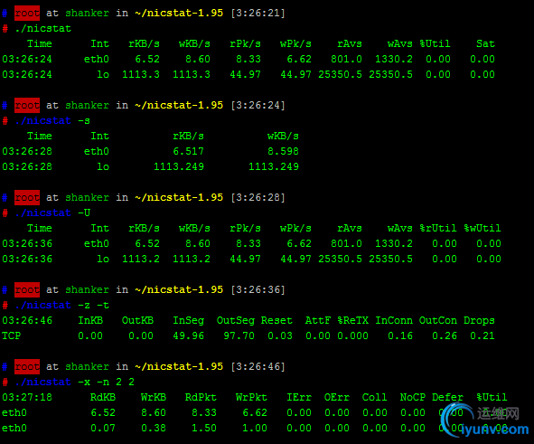

# root at shanker in ~/nicstat-1.95 [3:00:43]
# ./nicstat.sh -h
USAGE: nicstat [-hvnsxpztualMU] [-i int[,int...]]
   [-S int:mbps[,int:mbps...]] [interval [count]]
         -h                 # help
         -v                 # show version (1.95)
         -i interface       # track interface only
         -n                 # show non-local interfaces only (exclude lo0)
         -s                 # summary output
         -x                 # extended output
         -p                 # parseable output
         -z                 # skip zero value lines
         -t                 # show TCP statistics
         -u                 # show UDP statistics
         -a                 # equivalent to "-x -u -t"
         -l                 # list interface(s)
         -M                 # output in Mbits/sec
         -U                 # separate %rUtil and %wUtil
         -S int:mbps[fd|hd] # tell nicstat the interface
                            # speed (Mbits/sec) and duplex
    eg,
       nicstat              # print summary since boot only
       nicstat 1            # print every 1 second
       nicstat 1 5          # print 5 times only
       nicstat -z 1         # print every 1 second, skip zero lines
       nicstat -i hme0 1    # print hme0 only every 1 second
