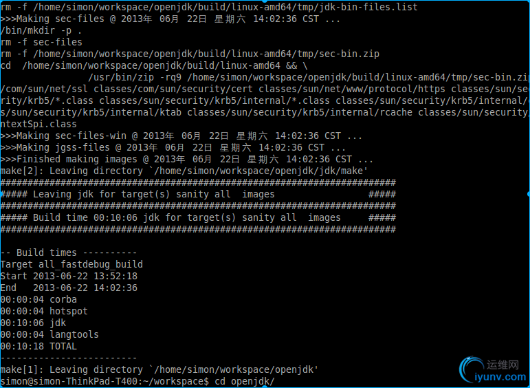

 如果出现:Sanity check passed.则表示测试编译通过了,不过也别开心得太早,真正make的时候不保证一定没问题,也许还会缺少某些依赖。
编译脚本:
写道
#!/bin/bash
# cd jdk source code folder
cd ~/workspace/openjdk
# export ALT_BOOTDIR
export LANG=C ALT_BOOTDIR=/usr/belleing/java
# set build profile,first 'chmod +x jdk_generic_profile.sh'
jdk/make/jdk_generic_profile.sh
# disable JAVA_HOME
export -n JAVA_HOME
# export ALT_JDK_IMPORT_PATH
export ALT_JDK_IMPORT_PATH=/usr/belleing/java
# start build
export ALLOW_DOWNLOADS=true
make DEBUG_NAME=all_fastdebug
#make DEBUG_NAME=all_fastdebug BUILD_JAXWS=false BUILD_JAXP=false
