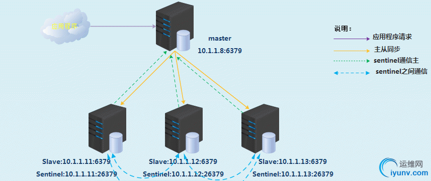

架构图如下:
1.sentinel 说明

3.架构规划
master:10.1.1.8:6379
salve1:10.1.1.11:6379
salve2:10.1.1.12:6379
salve3:10.1.1.13:6379
sentinel:10.1.1.11:26379
sentinel:10.1.1.12:26379
sentinel:10.1.1.13:26379

[11501] 29 Apr 18:23:17.534 # +failover-state-select-slave master ckl_master10.1.1.8 6379
[11501] 29 Apr 18:23:17.634 # +selected-slave slave 10.1.1.11:6379 10.1.1.116379 @ ckl_master10.1.1.8 6379 //选举新的主节点
[11501] 29 Apr 18:23:17.635 * +failover-state-send-slaveof-noone slave 10.1.1.11:6379 10.1.1.116379 @ ckl_master10.1.1.8 6379
[11501] 29 Apr 18:23:17.711 * +failover-state-wait-promotion slave 10.1.1.11:6379 10.1.1.116379 @ ckl_master10.1.1.8 6379
[11501] 29 Apr 18:23:18.535 # +promoted-slave slave 10.1.1.11:6379 10.1.1.116379 @ ckl_master10.1.1.8 6379
[11501] 29 Apr 18:23:18.535 # +failover-state-reconf-slaves master ckl_master10.1.1.8 6379
[11501] 29 Apr 18:23:18.541 * +slave-reconf-sent slave 10.1.1.13:6379 10.1.1.136379 @ ckl_master10.1.1.8 6379 //重设配置指定新的主节点
[11501] 29 Apr 18:23:19.532 * +slave-reconf-inprog slave 10.1.1.13:6379 10.1.1.136379 @ ckl_master10.1.1.8 6379
[11501] 29 Apr 18:23:19.532 * +slave-reconf-done slave 10.1.1.13:6379 10.1.1.136379 @ ckl_master10.1.1.8 6379
[11501] 29 Apr 18:23:19.584 # -odown master ckl_master10.1.1.8 6379
[11501] 29 Apr 18:23:19.584 * +slave-reconf-sent slave 10.1.1.12:6379 10.1.1.12 6379 @ ckl_master10.1.1.8 6379 //重设配置指定新的主节点
[11501] 29 Apr 18:23:20.589 * +slave-reconf-inprog slave 10.1.1.12:6379 10.1.1.12 6379 @ ckl_master10.1.1.8 6379
[11501] 29 Apr 18:23:20.589 * +slave-reconf-done slave 10.1.1.12:6379 10.1.1.12 6379 @ ckl_master10.1.1.8 6379
[11501] 29 Apr 18:23:20.640 # +failover-end master ckl_master10.1.1.8 6379
[11501] 29 Apr 18:23:20.640 # +switch-master ckl_master10.1.1.8 6379 10.1.1.116379
[11501] 29 Apr 18:23:20.640 * +slave slave 10.1.1.13:6379 10.1.1.136379 @ ckl_master10.1.1.116379
[11501] 29 Apr 18:23:20.640 * +slave slave 10.1.1.12:6379 10.1.1.12 6379 @ ckl_master10.1.1.116379
[11501] 29 Apr 18:23:20.641 * +slave slave 10.1.1.8:6379 10.1.1.8 6379 @ ckl_master10.1.1.116379
[11501] 29 Apr 18:23:50.669 # +sdown slave 10.1.1.8:6379 10.1.1.8 6379 @ ckl_master10.1.1.116379
查看新选举的主节点信息:
10.1.1.11
9
10
11
12
13
# /usr/local/bin/redis-cli
127.0.0.1:6379> info
# Replication
role:master
connected_slaves:2
slave0:ip=10.1.1.13,port=6379,state=online,offset=67708,lag=0
slave1:ip=10.1.1.12,port=6379,state=online,offset=67852,lag=0
master_repl_offset:67852
repl_backlog_active:1
repl_backlog_size:1048576
repl_backlog_first_byte_offset:2
repl_backlog_histlen:67851
测试新的主从同步:
10.1.1.11:6379
127.0.0.1:6379> set port "1090"
10.1.1.12:6379
127.0.0.1:6379> get port
"1090"
10.1.1.13:6379
"1090"
