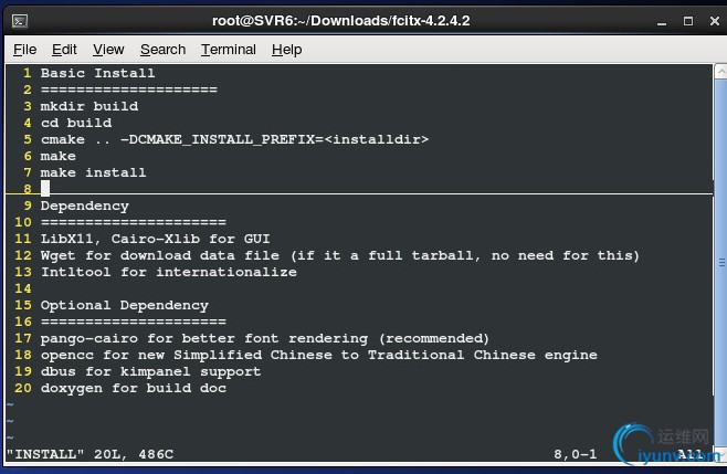

安装一个软件,首先看看里面的INSTALL,vim INSTALL
上面写好了安装步骤和依赖条件
1.  mkdir build
2.  cd build
3.  cmake .. -DCMAKE_INSTALL_PREFIX=/usr/local/fcitx
4.  make
5.  make install
按照步骤去执行

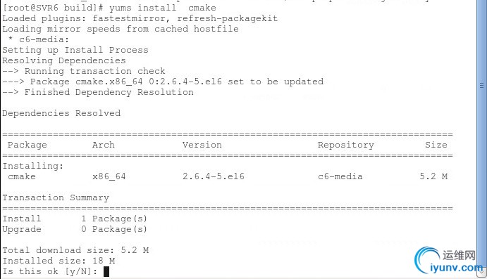

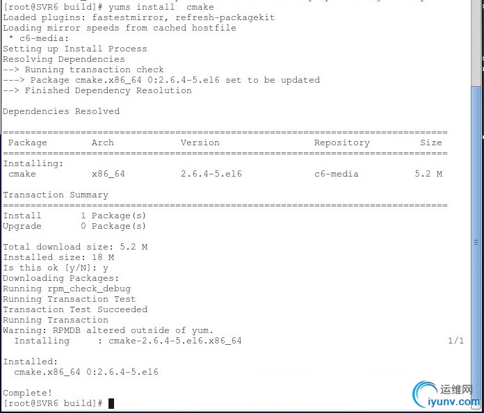

结果木有cmake,那再安装cmake,执行yum install cmake,或者从安装的iso中安装cmake,安装方法请参考
(redhat/CentOS/Fedora)Linux下利用ISO包或者光盘进行yum安装
使用yums install cmake

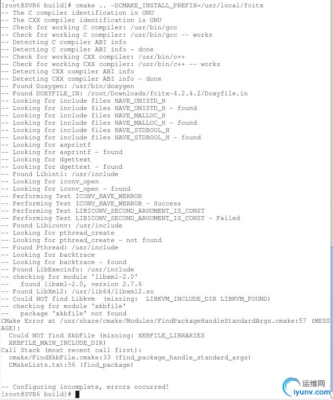

安装完毕后,继续按照INSTALL的进行安装
-- checking for module 'xkbfile'
--   package 'xkbfile' not found
CMake Error at /usr/share/cmake/Modules/FindPackageHandleStandardArgs.cmake:57 (MESSAGE):
  Could NOT find XkbFile (missing: XKBFILE_LIBRARIES
  XKBFILE_MAIN_INCLUDE_DIR)
Call Stack (most recent call first):
  cmake/FindXkbFile.cmake:33 (find_package_handle_standard_args)
  CMakeLists.txt:56 (find_package)
啊哦,出现了错误,查找下看看,原来提示说缺少package xkbfile,那就安装libxkbfile-devel
yum install libxkbfile-devel

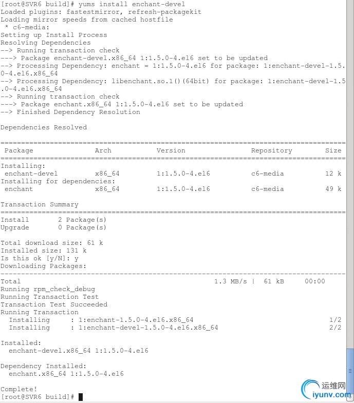

结果又出现了错误,错误原因:
  Could NOT find Enchant (missing: ENCHANT_LIBRARIES ENCHANT_INCLUDE_DIR)
  cmake/FindEnchant.cmake:31 (find_package_handle_standard_args)
  CMakeLists.txt:57 (find_package)
还是缺包,缺少package enchant,继续安装 enchant-devel

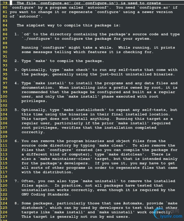

下载完后解压并查看INSTALL文件
其中描述是:
按照执行要求,我们一步一步的执行安装
1../configure
2.make
3.make check
4.make install
5.make installcheck

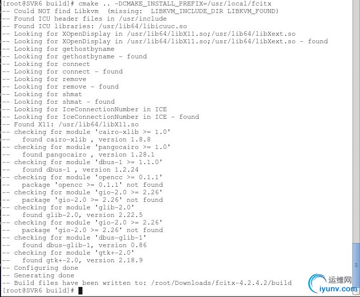

-- Could NOT find Libkvm  (missing:  LIBKVM_INCLUDE_DIR LIBKVM_FOUND)
-- Found Presage: /usr/local/lib/libpresage.so

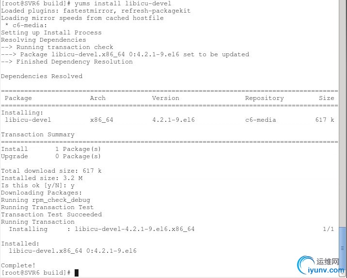

CMake Error at cmake/FindICU.cmake:72 (MESSAGE):
  Could not find ICU
  CMakeLists.txt:60 (find_package)
还是有错误,ICU,继续安装它们libicu-devel
这样就可以走完整个过程了:
结果如下:
接下来make,这个过程还挺快,有百分比显示,挺好,完毕后进行make install
