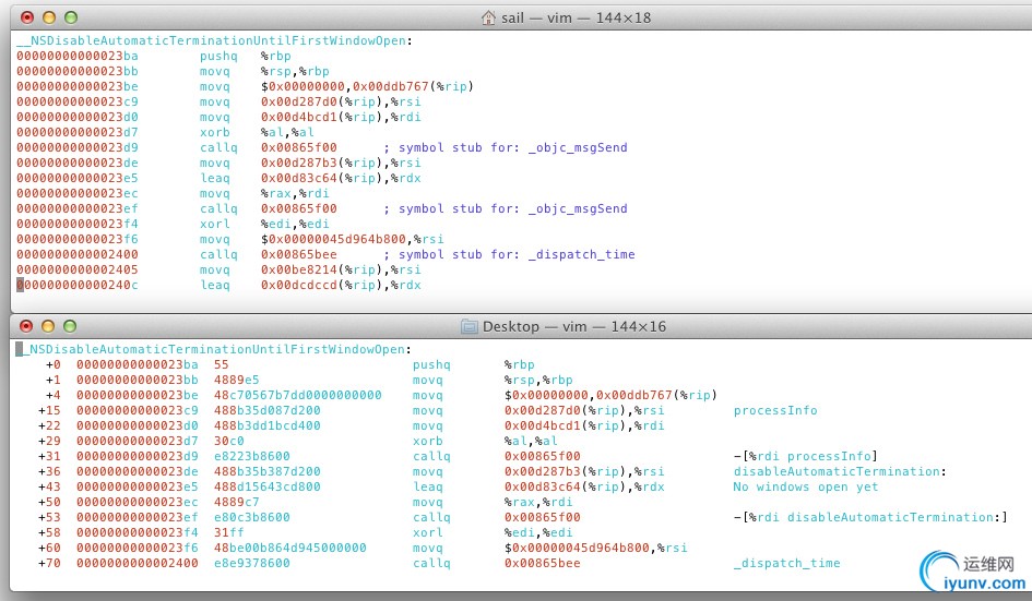

I've recently also started usingotx. This works very similarly to otool but in addition it will annotate the assembly. The best part is that it will resolve Objective-C calls making it much easier to tell what a function is doing. Here's a sample output of otool (top) vs otx (bottom):
Until I discovered otx I had to trace Objective-C using the si/ni commands in gdb to figure out what a function was doing.
