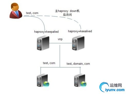

haproxy+keepalived实现高可用负载均衡 2011070610102256.jpg 我的环境:
haproxy keepalived 主:192.168.1.192
haproxy keepalived 备:192.168.1.193
vip:192.168.1.200

二:再两台机器上都分别启动:
/etc/init.d/keepalived start (这条命令会自动把haproxy启动)
三:测试:
1.再两台机器上分别执行ip add
主: eth0:
mtu 1500 qdisc pfifo_fast qlen 1000
link/ether 00:0c:29:98:cd:c0 brd ff:ff:ff:ff:ff:ff
inet 192.168.1.192/24 brd 192.168.1.255 scope global eth0
inet 192.168.1.200/32 scope global eth0
inet6 fe80::20c:29ff:fe98:cdc0/64 scope link
valid_lft forever preferred_lft forever
备: eth0:
link/ether 00:0c:29:a6:0c:7e brd ff:ff:ff:ff:ff:ff
inet 192.168.1.193/24 brd 255.255.255.254 scope global eth0
inet6 fe80::20c:29ff:fea6:c7e/64 scope link
2.停掉主上的haproxy,3秒后keepalived会自动将其再次启动
3.停掉主的keepalived,备机马上接管服务
备: eth0:
4.更改hosts
192.168.1.200 test.com
192.168.1.200 test.domain.com
通过IE测试,可以发现
test.com的请求发向了192.168.1.187:80
test.domain.com的请求发向了192.168.1.187:8000
