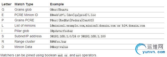

[iyunv@centos salt]# salt -C 'G@os:ubuntu' test.ping
server.hadoop.com:
True
[iyunv@centos salt]# salt -C 'E@server.\w+' test.ping
server.hadoop.com:
True
[iyunv@centos salt]# salt -C 'P@os:(centos)' test.ping
localhost:
    True
[iyunv@centos salt]# salt -C 'P@os:(centos|ubuntu)' test.ping
server.hadoop.com:
    True
localhost:
True
[iyunv@centos salt]# salt -C 'L@localhost,server.hadoop.com' test.ping
server.hadoop.com:
    True
localhost:
True
[iyunv@centos salt]# salt -C 'S@192.168.56.0/24' test.ping
server.hadoop.com:
    True
localhost:
True
