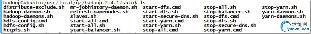

当然在目录hadoop-2.4.1/sbin下面会有很多启动文件:
里面会有所有服务各自启动的命令,而start-all.sh则是把所有服务一起启动,以下为.sh的内容:

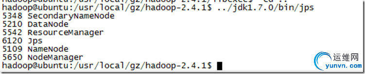

执行完成之后调用jps查看是否所有服务都已经启动起来了:
这里注意,一定要有6个服务,我启动的时候当时只有5个服务,打开两个连接都成功http://192.168.1.107:50070/http://192.168.1.107:8088/,但是在执行wordcount示例的时候,发现执行失败,查找原因之后,才发起我启动的时候少了datanode服务

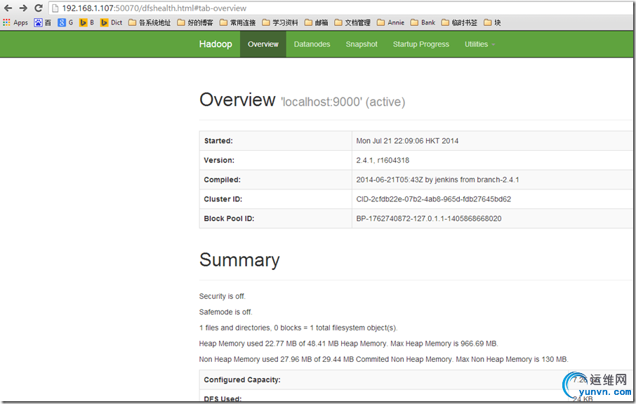

下面这个是application的运行情况:
下面这个是dfs的健康状态:

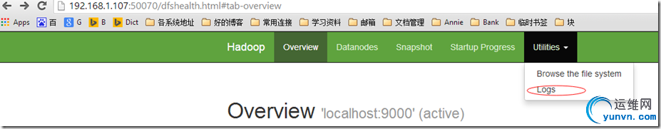

http://192.168.1.107:50070/打开的页面可以查看hadoop启动及运行的日志,详情如下:

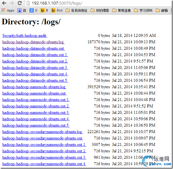

我就是通过这里的日志找到问题原因的,打开日志之后是各个服务运行的日志文件:
此时打开datanode-ubuntu.log文件,有相关异常抛出:
2014-07-21 22:05:21,064 INFO org.apache.hadoop.hdfs.server.common.Storage: Lock on /usr/local/gz/hadoop-2.4.1/dfs/data/in_use.lock acquired by nodename 3312@ubuntu2014-07-21 22:05:21,075 FATAL org.apache.hadoop.hdfs.server.datanode.DataNode: Initialization failed for Block pool  (Datanode Uuid unassigned) service to localhost/127.0.0.1:9000. Exiting. java.io.IOException: Incompatible clusterIDs in /usr/local/gz/hadoop-2.4.1/dfs/data: namenode clusterID = CID-2cfdb22e-07b2-4ab8-965d-fdb27645bd62; datanode clusterID = ID-2cfdb22e-07b2-4ab8-965d-fdb27645bd62        at org.apache.hadoop.hdfs.server.datanode.DataStorage.doTransition(DataStorage.java:477)        at org.apache.hadoop.hdfs.server.datanode.DataStorage.recoverTransitionRead(DataStorage.java:226)        at org.apache.hadoop.hdfs.server.datanode.DataStorage.recoverTransitionRead(DataStorage.java:254)        at org.apache.hadoop.hdfs.server.datanode.DataNode.initStorage(DataNode.java:974)        at org.apache.hadoop.hdfs.server.datanode.DataNode.initBlockPool(DataNode.java:945)        at org.apache.hadoop.hdfs.server.datanode.BPOfferService.verifyAndSetNamespaceInfo(BPOfferService.java:278)        at org.apache.hadoop.hdfs.server.datanode.BPServiceActor.connectToNNAndHandshake(BPServiceActor.java:220)        at org.apache.hadoop.hdfs.server.datanode.BPServiceActor.run(BPServiceActor.java:816)        at java.lang.Thread.run(Thread.java:722)2014-07-21 22:05:21,084 WARN org.apache.hadoop.hdfs.server.datanode.DataNode: Ending block pool service for: Block pool  (Datanode Uuid unassigned) service to localhost/127.0.0.1:90002014-07-21 22:05:21,102 INFO org.apache.hadoop.hdfs.server.datanode.DataNode: Removed Block pool  (Datanode Uuid unassigned)2014-07-21 22:05:23,103 WARN org.apache.hadoop.hdfs.server.datanode.DataNode: Exiting Datanode2014-07-21 22:05:23,106 INFO org.apache.hadoop.util.ExitUtil: Exiting with status 02014-07-21 22:05:23,112 INFO org.apache.hadoop.hdfs.server.datanode.DataNode: SHUTDOWN_MSG: /************************************************************SHUTDOWN_MSG: Shutting down DataNode at ubuntu/127.0.1.1************************************************************/根据错误日志搜索之后发现是由于先前启动Hadoop之后,再使用命令格式化namenode会导致,datanode和namenode的clusterID不一致:找到hadoop/etc/hadoop/hdfs-site.xml配置文件里配置的datanode和namenode下的./current/VERSION,文件,对比两个文件中的clusterID,不一致,将Datanode下的clusterID改为namenode下的此ID,重新启动之后即可。
