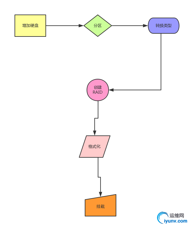

    一、准备用于RAID阵列的分区
    (一)增加硬盘、分区(关掉虚拟机的情况下,增加硬盘)
        A.增加硬盘(虚拟机是这样,真机是需要加硬盘)
        B.对“/dev/sde1、/dev/sdg1、/dev/sdh1、/dev/sdf1、/dev/sd ”进行分区以及检验分区信息
        C.转换类型为Linux raid autodetect(fd)以及查看转换后的信息

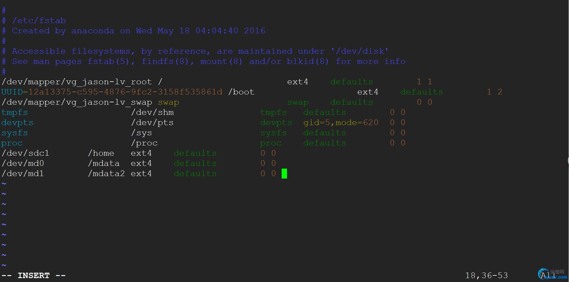

    五、修改/etc/fstab文件,实现开机自动启动
        修改fstab配置文件,达到开机后自动挂载的目的。
        A.备份fstab
        B.修改文件
        C.测试修改的效果
            卸载
            重新挂载
            查看挂载信息
1.先备份一下fstab文件
[iyunv@test2 etc]# cp fstab fstab.bak2
2.更改配置文件
[iyunv@test2 etc]# vim fstab
[iyunv@test2 etc]#
3.测试是否奏效:
a.先卸载并查看挂载信息:
[iyunv@test2 etc]# umount /dev/md1
[iyunv@test2 etc]# mount | grep "md1"
b.挂载,并查看信息:
[iyunv@test2 etc]# mount /mdata2
/dev/md1 on /mdata2 type ext4 (rw)

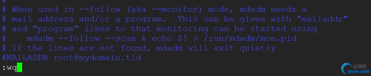

查看example:
[iyunv@test2 etc]# vim mdadm.conf
[jason@test2 ~]$ vim /usr/share/doc/mdadm-3.2.6/mdadm.conf-example
# mdadm configuration file
# mdadm will function properly without the use of a configuration file,
# but this file is useful for keeping track of arrays and member disks.
# In general, a mdadm.conf file is created, and updated, after arrays
# are created. This is the opposite behavior of /etc/raidtab which is
# created prior to array construction.
# the config file takes two types of lines:
#   DEVICE lines specify a list of devices of where to look for
# potential member disks
#   ARRAY lines specify information about how to identify arrays so
# so that they can be activated
# You can have more than one device line and use wild cards. The first
# example includes SCSI the first partition of SCSI disks /dev/sdb,
# /dev/sdc, /dev/sdd, /dev/sdj, /dev/sdk, and /dev/sdl. The second
# line looks for array slices on IDE disks.
#DEVICE /dev/sd[bcdjkl]1
#DEVICE /dev/hda1 /dev/hdb1
# If you mount devfs on /dev, then a suitable way to list all devices is:
#DEVICE /dev/discs/*/*
# The AUTO line can control which arrays get assembled by auto-assembly,
# meaing either "mdadm -As" when there are no 'ARRAY' lines in this file,
# or "mdadm --incremental" when the array found is not listed in this file.
# By default, all arrays that are found are assembled.
# If you want to ignore all DDF arrays (maybe they are managed by dmraid),
# and only assemble 1.x arrays if which are marked for 'this' homehost,
# but assemble all others, then use
#AUTO -ddf homehost -1.x +all
# ARRAY lines specify an array to assemble and a method of identification.
# Arrays can currently be identified by using a UUID, superblock minor number,
# or a listing of devices.
#   super-minor is usually the minor number of the metadevice
#   UUID is the Universally Unique Identifier for the array
# Each can be obtained using
#   mdadm -D <md>
#ARRAY /dev/md0 UUID=3aaa0122:29827cfa:5331ad66:ca767371
#ARRAY /dev/md1 super-minor=1
#ARRAY /dev/md2 devices=/dev/hda1,/dev/hdb1
# ARRAY lines can also specify a "spare-group" for each array.  mdadm --monitor
# will then move a spare between arrays in a spare-group if one array has a failed
# drive but no spare
#ARRAY /dev/md4 uuid=b23f3c6d:aec43a9f:fd65db85:369432df spare-group=group1
#ARRAY /dev/md5 uuid=19464854:03f71b1b:e0df2edd:246cc977 spare-group=group1
# When used in --follow (aka --monitor) mode, mdadm needs a
# mail address and/or a program.  This can be given with "mailaddr"
# and "program" lines to that monitoring can be started using
#mdadm --follow --scan & echo $! > /run/mdadm/mon.pid
# If the lines are not found, mdadm will exit quietly
#MAILADDR root@mydomain.tld
#PROGRAM /usr/sbin/handle-mdadm-events
  65,1  Bot

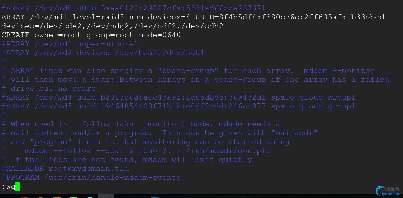

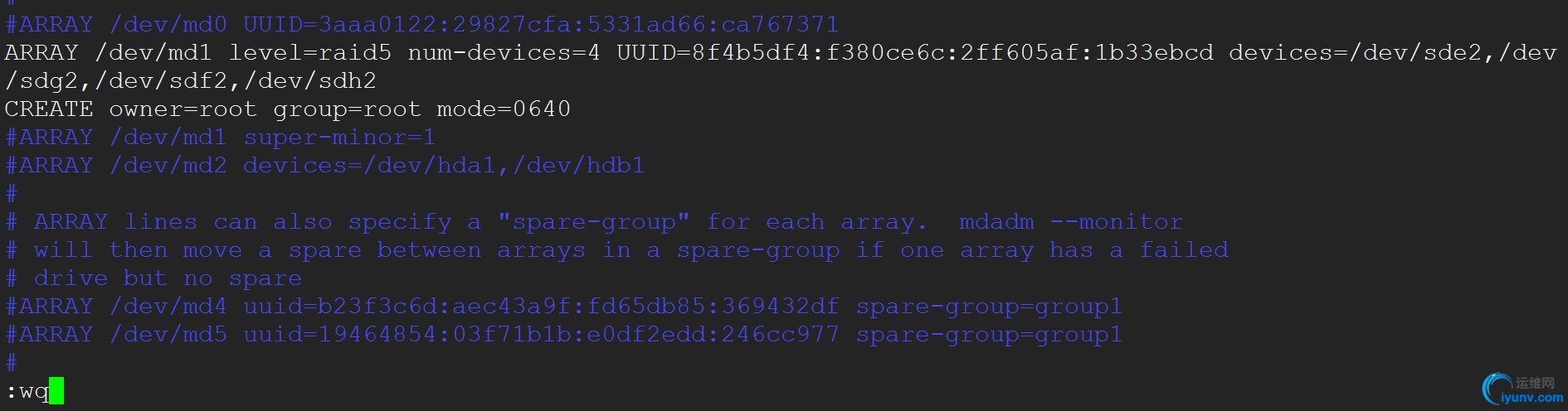

修改:
[iyunv@test2 jason]# mdadm -S /dev/md1
mdadm: unrecognised word on ARRAY line: levle=raid5
mdadm: Unknown keyword devices=/dev/sde2,/dev/sdg2,/dev/sdf2,/dev/sdh2
mdadm: Cannot get exclusive access to /dev/md1:Perhaps a running process, mounted filesystem or active volume group?
分析:这里有两个错误
    拼写错误
    devices是未知的关键字
man mdadm.conf
devices=
The value is a comma separated list of device names or device name pat-terns. Only devices with names which match one entry in the list will be used to assemble the array. Note that the devices listed there must also be listed on a DEVICE line.
解释:devices和DEVICE要在一行,才可以被识别。
修改level拼写
[iyunv@test2 jason]# vim /etc/mdadm.conf
修改devices:[iyunv@test2 jason]# vim /etc/mdadm.conf
查看md1:
[iyunv@test2 jason]# cat /proc/mdstat
Personalities : [raid6] [raid5] [raid4]
md1 : active raid5 sde2[0] sdh2[5] sdg2[2] sdf2[1]
  6306816 blocks super 1.2 level 5, 512k chunk, algorithm 2 [4/4] [UUUU]
md0 : active raid5 sde1[5] sdf1[4] sdh1[2] sdg1[1]
unused devices: <none>
查看md1的属组和属主:
[iyunv@test2 jason]# ls -lh /dev/md1
brw-rw---- 1 root disk 9, 1 Jun 20 20:34 /dev/md1
未能实现:通过CREATE改变group和mode.
