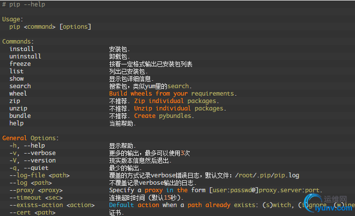

# pip search "multiprocessing"
6、列出安装的packages
# pip freeze
