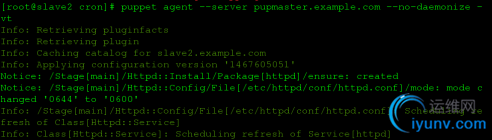

client端进行验证:
# puppet agent --server pupmaster.example.com --no-daemonize -vt
