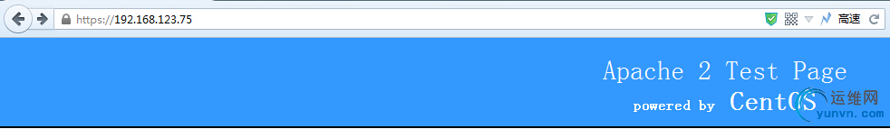

访问浏览器测试,输入192.168.123.75回车以后自动转成https://192.168.123.75 143750_ORHB_86462.png
查看rewrite.log日志,红色的表示rewrite的动作
# tail -f /var/log/httpd/rewrite.log
172.16.10.48 - - [19/Jun/2014:12:28:32 +0800] [192.168.123.75/sid#7f9ee141f860][rid#7f9ee1d18338/initial] (2) init rewrite engine with requested uri /
172.16.10.48 - - [19/Jun/2014:12:28:32 +0800] [192.168.123.75/sid#7f9ee141f860][rid#7f9ee1d18338/initial] (3) applying pattern '^.*$' to uri '/'
172.16.10.48 - - [19/Jun/2014:12:28:32 +0800] [192.168.123.75/sid#7f9ee141f860][rid#7f9ee1d18338/initial] (4) RewriteCond: input='80' pattern='80' => matched
172.16.10.48 - - [19/Jun/2014:12:28:32 +0800] [192.168.123.75/sid#7f9ee141f860][rid#7f9ee1d18338/initial] (2) rewrite '/' -> 'https://192.168.123.75/'
172.16.10.48 - - [19/Jun/2014:12:28:32 +0800] [192.168.123.75/sid#7f9ee141f860][rid#7f9ee1d18338/initial] (2) explicitly forcing redirect with https://192.168.123.75/
172.16.10.48 - - [19/Jun/2014:12:28:32 +0800] [192.168.123.75/sid#7f9ee141f860][rid#7f9ee1d18338/initial] (1) escaping https://192.168.123.75/ for redirect
172.16.10.48 - - [19/Jun/2014:12:28:32 +0800] [192.168.123.75/sid#7f9ee141f860][rid#7f9ee1d18338/initial] (1) redirect to https://192.168.123.75/ [REDIRECT/302]

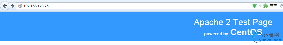

测试看看
首先,我们访问ip地址192.168.123.75,打开默认页面,不会转到https,如下图
访问192.168.123.75/login.html,立马就转到https协议了
访问域名的效果与访问ip一样。
