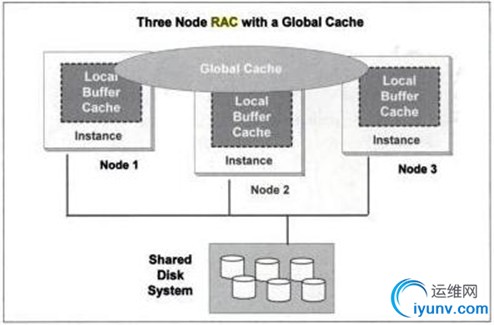

  Cache Fusion basically is aboutfusing the memory buffer cache of multiple instance into one single cache.For example if we have 3 instance in a RAC which is using the same datafiles and each instance is having its own memory buffer cache in thereown SGA, then cache fusion will make the database behave as if it has a single instance and the total buffer cache is the sum of buffer cache of all the 3 instance. Below figure shows what I mean.
  This behavior is possible because of high speed interconnect existing in the cluster between each instance.Each of instance is connected to other instance using a high-speed interconnect. This makes it possible to share the memory between 2 or moreservers. Previously only datafile sharing was possible, now because of interconnect, even the cache memory can be shared.
  But how this helps? Well, for example if we have a data block in one of the instance and its updating the block and other instance needs the same data block then this data block can be copied from holding instance buffer cache to requesting instancebuffer cache using this high-speed interconnect.This high speed interconnect is a private connection made just for sending data blocks and more by instances.External users cannot use this connection. It is this interconnect which makes multiple server behavelike a cluster.These servers are bind together using this interconnect.

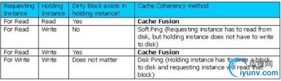

Maintaining the consistency of data blocks in the buffer cache of multiple instance iscalled “Cache Coherency”.

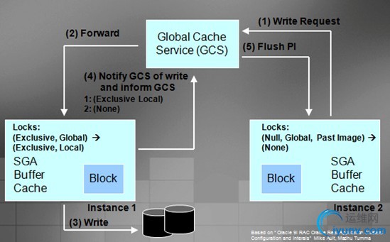

  Global Cache Service (GCS) is the main component of Oracle Cache Fusion technology.This is represented by background process LMSn.There can be max 10 LMS process for an instance. The main function of GCS is to track the status and location of datablocks. Status of data block means the mode and role of data block (I will explain mode and role further). GCS is the main mechanism by which cache coherency among “multiple cache” is maintained.GCS is also responsible for block transfer between the instances.

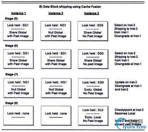

  Stage 1
  In stage 1 datablock is requested by a user C who is connected to instance 3. So a data block is read into the buffer cache of instance 3.
  SQL>select sales_rank from salesman where salesid = 10;
  Assume this gives a value of 30. This block is read for the first time and its not present in any other instance. So the role of block is LOCAL and the block is read in SHARED mode. Also there are NO PAST IMAGES. So we describe this stage has instance3 havingSL0 mode (SHARED, LOCAL, 0 PAST IMAGES).
  关于这些Lock Modes,在我的Blog里有说明:
  Oracle RAC Past Image(PI)说明
  http://blog.csdn.net/xujinyang/article/details/6833311
  Stage 2
  In stage 2 user B issues the same select statement against the salesman table. Instance 2 will need the same block; therefore, the block is shipped from instance 3 to instance 2 via cache fusion interconnect.There is no disk read at this time. Bothinstances are in SHARED mode (S) and role is LOCAL (L). Here if you see carefully that even though the block is present in more then once instance, still we say that role is local because the block is not yet dirtied.Had the block been dirty and then requestedby other instance, then in that case the role will change to global.
  Stage 3
  In stage 3 user B decides to update the row and commit at instance 2. The new sales rank is 24. At this stage, instance 2 acquires EXCLUSIVE lock for updating the data at instance 2 andSHARED lock from instance 3 is downgraded to NULL lock.
  SQL>update salesman set sales_rank = 24 where salesid = 10;
  SQL>commit;
  So instance 2 is having a mode XL0 (Exclusive, Local with 0 past images) and instance 3 is having a NULL lock, which is just a place holder.Also the role of the block is still LOCAL because the block is dirtied for the first time only on instance2 and no other instance is having any dirty copy of that.If another instance now tries to update same block the role will change to global.
  Stage 4
  In stage 4 user A decides to update in instance 1 the same row and hence the same block with sales rank of 40. It finds that block is dirtied in instance 2. Therefore the data block is shipped to instance 1 from instance 2,however, a PAST IMAGE ofthe data block is created on instance 2 and lock mode on instance 2 is downgraded to NULL with a GLOBAL role.Instance 2 now has NG1 (NULL lock with GLOBAL role and 1 PAST IMAGE). At this time instance 1 will have EXCLUSIVE lock with GLOBAL role (XG0).
  Stage 5
  User C executes a select statement from instance 3 on same row. The data block from instance 1 being the most recent copy (GRD (Global Resource Directory) knows this information about which instance is having the latest copy of data block), it isshipped to instance 3.As a result the lock on instance 1 is converted to SHARED GLOBAL with 1 PAST IMAGE.The reason the lock gets changed to SHARED and not NULL isbecause instance 3 asked for shared lock (for reading data) and not exclusive lock (for updatingdata).If the instance 3 asked for exclusive lock then the instance 1 would have had NULL lock.
  Also the instance 3 will now hold SG0 (SHARED, GLOBAL with 0 PAST IMAGES).
  Stage 6
  User B issues the same select statement against the salesman table on instance 2. Instance 2 will request for a consistent copy of buffer from another instance, which happens to be the current master.
Therefore instance 1 will ship the block to instance 2, where it will be required with SG1 (SHARED, GLOBAL with 1 PAST IMAGE).So instance 2 mode becomes SG1.
  Stage 7
  User C on instance 3 updates the same row. Therefore the instance 3 requires an exclusive lock and instance 1 and instance 2 will be downgraded to NULL lock with GLOBAL role and 1 PAST IMAGE.Instance 3 will have EXCLUSIVE lock, GLOBAL role and withno PAST IMAGES (XG0).
  Stage 8
  The checkpoint is initiated and a “Write to Disk” takes place at instance 3. As a result previous past images will be discarded (as they are not required for recovery) and instance 3 will hold that block in EXCLUSIVE lock LOCAL role with no PAST IMAGES(XL0).
  Further if any instance wants to read or write on the same block then a copy will be again shifted from instance 3.
