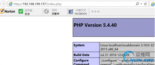

4.制作测试页面进行测试
~]#mv/usr/local/apache24/htdocs/index.{html,php}
~]#vim/usr/local/apache24/htdocs/index.php
  <?php
     Phpinfo();

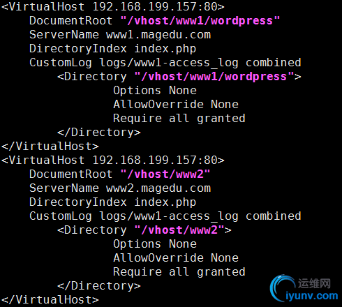

6.安装wordpress和phpMyAdmin
(1)在httpd主配置文件中注释掉#DocumentRoot "/usr/local/apache24/htdocs"
  将Include /etc/httpd24/extra/httpd-vhosts.conf取消注释。
(2)创建两个虚拟主机www1.magedu.com和www2.mage.com
~]#mkdir -pv /vhost/www{1,2}
~]#vim /etc/httpd24/extra/httpd-vhosts.conf

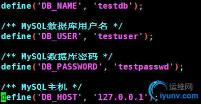

(3)下载worepress并解压至/vhost/www1/目录下,修改配置文件:
~]#mv wp-config-sample.php wp-config.php
~]#vim wp-config.php
