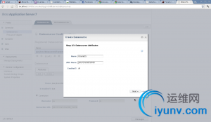

Step4). In Wizard “Step 1/3: Datasource Attributes”
Enter the DataSource Name as “OracleDS”
Enter JNDI Name as “java:/OracleDSJNDI” or “java:jboss/OracleDSJNDI” (NOTE the valid DataSource name should start with either java:/ or with java:jboss/ prefix)
DataSource name & JNDI Name

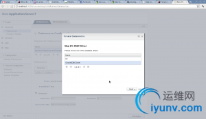

  Step5). Now in the next Section “Step 2/3: JDBC Driver” you will see all the installed drivers details. in above case as we already registered oracle driver as a module “OracleJDBCDriver” in previous section so we will be able to see the details as following:
Registered Jdbc Drivers List

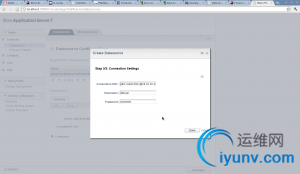

  Step6). In next section “” provide the Database url (jdbc:oracle:thin:@10.10.10.10:1521:DB_SID) ,username and password
Specifying DataSource properties

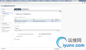

  Step7). you will see following kind of messae in your JBoss AS 7 console output:
DataSource Details
10:50:32,330 INFO  [org.jboss.as.connector.subsystems.datasources] (MSC service thread 1-6) Bound data source [OracleDSJNDI]
