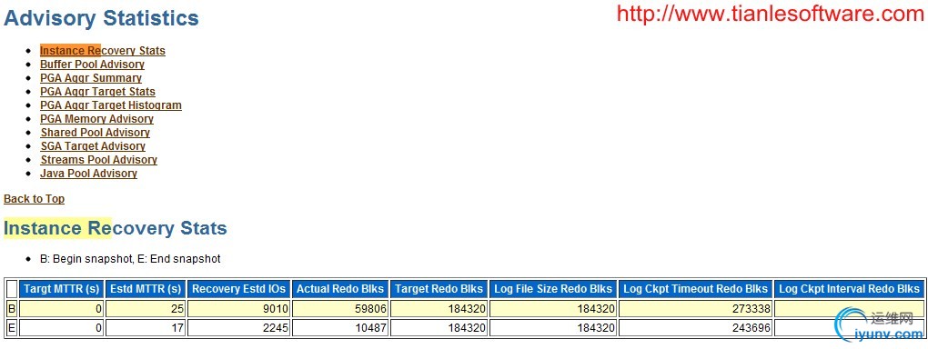

  As part of theongoing monitoring of your database, you can periodicallycompareV$INSTANCE_RECOVERY.TARGET_MTTRtoyourFAST_START_MTTR_TARGET. The two values should generally be the sameif theFAST_START_MTTR_TARGETvalue is in the practical range.IfTARGET_MTTRis consistently longerthanFAST_START_MTTR_TARGET, then setFAST_START_MTTR_TARGETtoa value no less thanTARGET_MTTR. IfTARGET_MTTRis consistentlyshorter, then setFAST_START_MTTR_TARGETto a value no greaterthanTARGET_MTTR.
  可以比较V$INSTANCE_RECOVERY.TARGET_MTTR和 FAST_START_MTTR_TARGET的值,如果相差较大,就调整他们到一致。

  Now wait forsixty seconds and reissue the query toV$INSTANCE_RECOVERY. OracleDatabase responds with the following:
  TARGET_MTTR ESTIMATED_MTTR
  1825
  The estimatedMTTR at this time has dropped to 25 seconds, because some of the dirty buffershave been written out during this period
  --在过一分钟来查询,就可以发现ESTIMATED_MTTR的值变成了25. 因为一些dirtybuffers 已经写到disk了。

四. AWR 报告中有关Instance Recovery 说明
  从这个AWR报告中,我们也可以看出MTTR的信息,我这里没有设置Target MTTR,所以这里显示为0.Estd MTTR 是估算的值。
