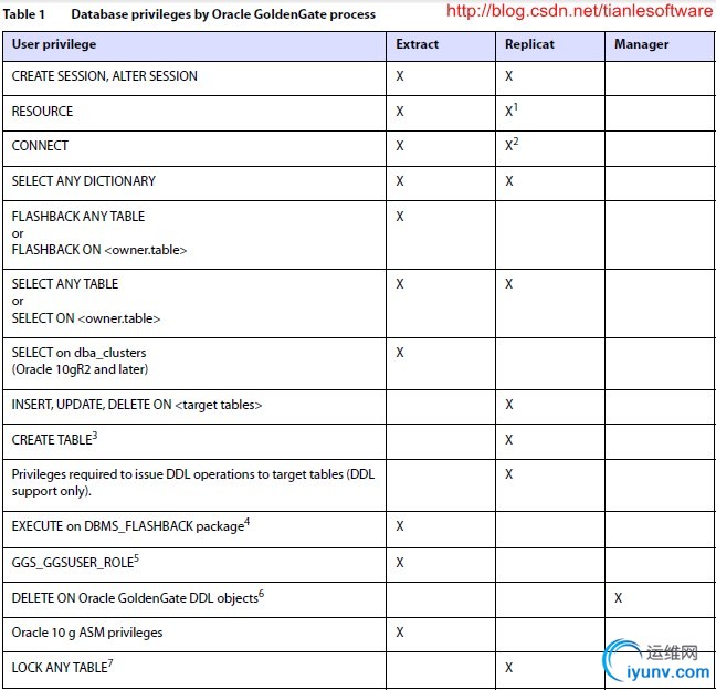

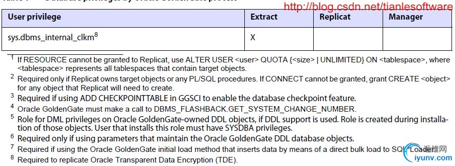

十三. Database privileges
  Certainprivileges are required for a regular Oracle instance, plus additionalprivileges for an ASM instance and additional privileges for Oracle EnterpriseEdition 10.2 or later.
  1.Regular Oracle database instance
  To assign the correct privileges to theOracle GoldenGate database user, see Table 1.

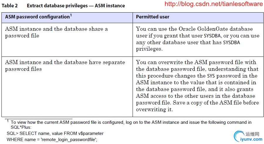

2.Oracle ASM instance
  If Oracle 10g AutomaticStorage Management (ASM) is in use, Oracle GoldenGate requires a user for theExtract process to access the ASM instance. Oracle GoldenGate does not supportusing operating-system authentication for the ASM user. You can use SYS user orany user with SYSDBA privileges in the ASM instance. See Table 2.
  --如果使用ASM,GG 需要能够访问ASM instance。

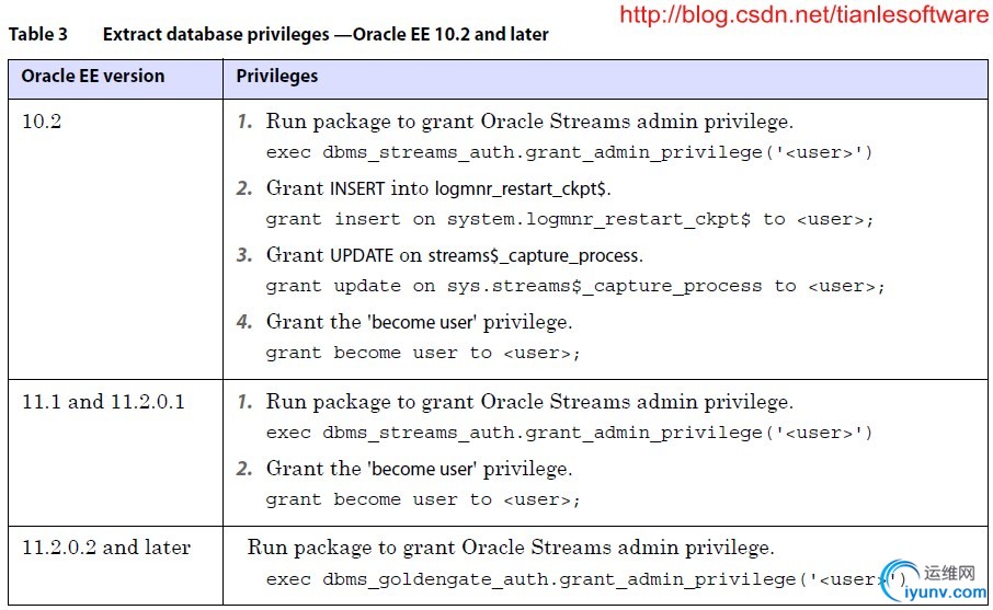

3. Oracle Enterprise Edition 10.2 or later instance
  In OracleEnterprise Edition 10.2 or later, the additional privileges in Table 3 arerequired for the Extract database user. In these Enterprise Edition versions,Oracle Recovery Manager (RMAN) works with Extract to retain the archive logsthat Extract needs for recovery. The special privileges are required forinteraction with an underlying Oracle Streams Capture and with RMAN.
