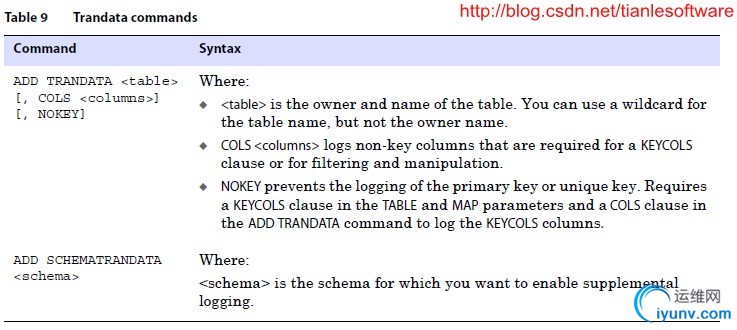

1.1.4.1 ADD TRANDATA
  The ADD TRANDATA command enables table-level logging and is generally appropriate if you willnot be using the Oracle GoldenGate DDL replication feature, or if you want to use that feature and your data meets certain requirements documented for this command in the Windows and UNIX Reference Guide.
1.1.4.2 ADD SCHEMATRANDATA
  The ADD SCHEMATRANDATA command enables schema-level logging. It logs more key values to the redo log than ADD TRANDATA does, and it affects all of the current and future tables of a given schema. Because ADD SCHEMATRANDATA logs key values atomically when each DDL operation occurs, it is the preferred logging method to use if you will be using the Oracle GoldenGate DDL replication feature. (If thedatabase system can tolerate the extra redo data, you can also use ADDSCHEMATRANDATA without using the DDL replication feature.)

  1. On the source system, run GGSCI from theOracle GoldenGate directory.
  2. In GGSCI, issue the following command tolog on to the database.
  DBLOGIN USERID<user>, PASSWORD <password>
  Where:<user> is a database user who has the privilege to enable table-level orschemalevel supplemental logging, depending on the logging command that youwill be choosing from Table 9, and <password> is that user’s password.
  3. Issue the ADD TRANDATA or ADD SCHEMATRANDATA command.

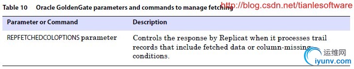

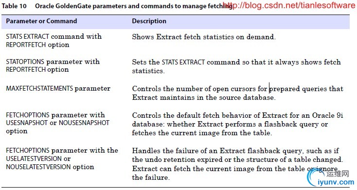

  Oracle GoldenGate provides the following parameters to manage fetching.

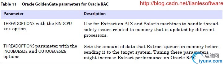

  The following table shows some OracleGoldenGate parameters that are of specific benefitin Oracle RAC.
  1.11.2 Special procedures on RAC

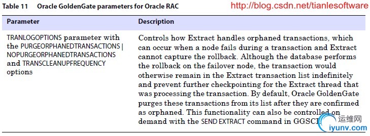

  (1) If the primary database instanceagainst which Oracle GoldenGate is running stops or fails for any reason,Extract abends. To resume processing, you can restart the instance or mount theOracle GoldenGate binaries to another node where the database is running andthen restart the Oracle GoldenGate processes. Stop the Manager process on theoriginal node before starting Oracle GoldenGate processes from another node.
  (2) Whenever the number of redothreads changes, the Extract group must be dropped and re-created.
  (3) To write SQL operations to thetrail, Extract must verify that there are no other operations from other RACnodes that precede the ones in the redo log that it is reading. For example, ifa log contains operations that were performed from 1:00 a.m. to 2:00 a.m., andthe log from Node 2 contains operations that were performed from 1:30 a.m. to2:30 a.m., then only the operations up to, and including, the 2:00 a.m. one canbe moved to the server where the main Extract is coordinating the redo data. Extractmust ensure that there are no more operations between 2:00 a.m. and 2:30a.m.that need to be captured.
  (4) In active-passive environments,the preceding requirement means that you might need to perform some operationsand archive log switching on the passive node to ensure that operations fromthe active node are passed to the passive node. This eliminates any issues thatcould arise from a slow archiver process, failed network links, and other latencyissues caused by moving archive logs from the Oracle nodes to the server where themain Extract is coordinating the redo data.
  (5) To process the last transaction ina RAC cluster before shutting down Extract, insert a dummy record into a sourcetable that Oracle GoldenGate is replicating, and then switch log files on allnodes. This updates the Extract checkpoint and confirms that all availablearchive logs can be read. It also confirms that all transactions in those archivelogs are captured and written to the trail in the correct order.

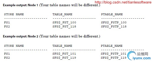

  5. (Recommended) After (and only after) theDBFS sequence generator is partitioned, create a new DBFS filesystem on eachsystem, and use only these filesystems for DML propagation with OracleGoldenGate. See “Configuring the DBFS filesystem”。
  NOTE:
  DBFS filesystemsthat were created before the patch for bug-9651229 was applied or before theDBFS sequence number was adjusted can be configured for propagation, but thatrequires additional steps not described in this document. If you must retainold filesystems, open a service request with Oracle Support.

  1.To identify the table namesthat back each filesystem, issue the following query.(Substitute your storenames for “FS1” and “FS2.”)
  Example select fs.store_name, tb.table_name,tb.ptable_name
  fromtable(dbms_dbfs_sfs.listTables) tb,
  table(dbms_dbfs_sfs.listFilesystems)fs
  wherefs.schema_name = tb.schema_name
  andfs.table_name = tb.table_name
  andfs.store_name in ('FS1', 'FS2')
  The output looks like the followingexamples.
  2.Identify the tables that are locallyread-write to Extract by creating the following TABLE statements in the Extractparameter files. (Substitute your owner and table names.)
  Example: Node 1
  TABLE owner.SFS$_FST_100;
  TABLE owner.SFS$_FSTP_100;
  Example: Node 2
  TABLE owner. SFS$_FST_119;

  In a RACconfiguration, Extract must have access to the online and archived logs for allnodes in the cluster, including the one where Oracle GoldenGate is installed.
  --RAC 环境下,Extract 必须能够访问所有节点的online 和archivedlog。 即RAC 环境下GG需要安装在共享文件系统上,这点在安装GG那部分有说明。

  1. Enable supplemental logging at the tablelevel and the database level for the tables in the source database.

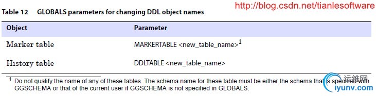

4.9 Changing DDL object names after installation
  Follow these steps to change the names of the Oracle GoldenGate DDL schema or other DDLobjects after they are installed. This procedure preserves the continuity ofsource and target DDL operations.
  1. Run GGSCI. Keep the session open for theduration of this procedure.
  2. Stop Extract to stop DDL capture.
  STOP EXTRACT<group>
  3. Stop Replicat to stop DDL replication.
  STOP REPLICAT<group>
  4. Change directories to the OracleGoldenGate installation directory.
  5. Run SQL*Plus and log in as a user thathas SYSDBA privileges.
  6. Disconnect all sessions that ever issuedDDL, including those of Oracle GoldenGate processes, SQL*Plus, businessapplications, and any other software that uses Oracle. Otherwise the databasemight generate an ORA-04021 error.
  7. Run the ddl_disable script to disablethe DDL trigger.
  8. To change the DDL schema name, specifythe new name in the local GLOBALS file.
  GGSCHEMA<new_schema_name>
  9. To change the names of any otherobjects, do the following:
  (1) Specify the new names in the params.sqlscript. Do not run this script.
  (2) If changing objects in Table 12,specify the new names in the local GLOBALS file. The correct parameters to useare listed in the Parameter column of this table.
