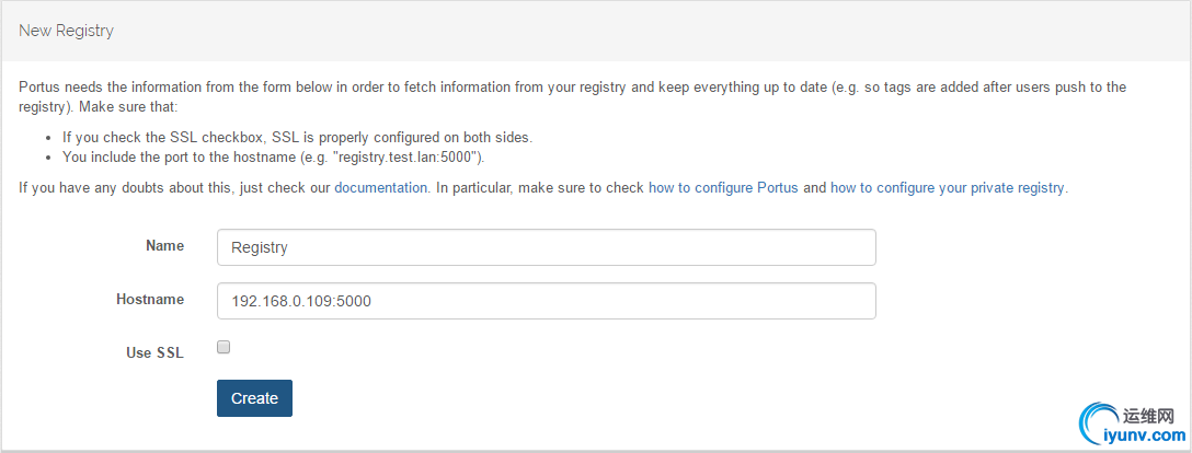

Open http://192.168.0.109:3000 with your browser and perform the following steps:
  1. Create an admin account
  2. You will be redirected to a page where you have to register the registry. In this form:
    - Choose a custom name for the registry.
    - Enter 192.168.0.109:5000 as the hostname.
    - Do *not* check the "Use SSL" checkbox, since this setup is not using SSL.

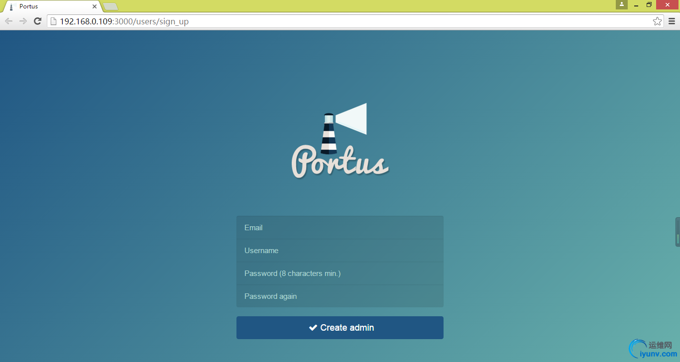

10、Portus初始化
在浏览器中打开创建默认管理员用户
连接到本docker仓库(也可以是其他仓库,必须是registry 2.0以上版本)
