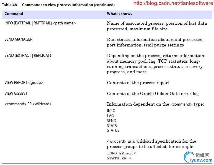

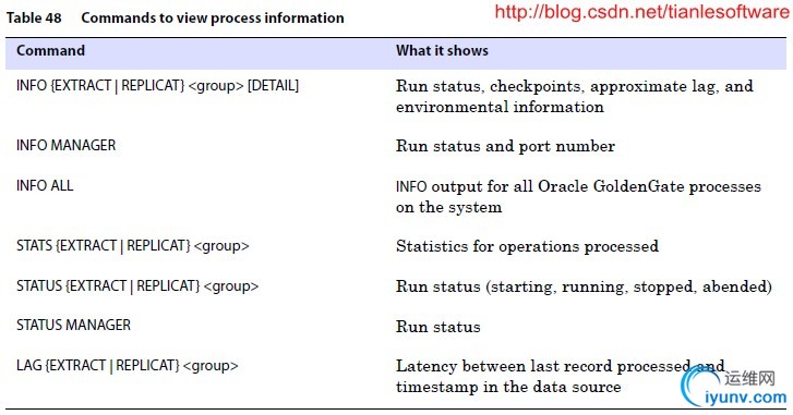

一.使用命令查看
  主要有如下命令:
  这里注意STATS 指静态的信息,而STATUS 是运行时的信息。

1.2 Monitoring lag
  Lag statisticsshow you how well the Oracle GoldenGate processes are keeping pace with theamount of data that is being generated by the business applications. With this information,you can diagnose suspected problems and tune the performance of the Oracle GoldenGateprocesses to minimize the latency between the source and target databases.
   Lag 的静态信息可以显示GG 进程处理的data 数量。
  For Extract, lagis the difference, in seconds, between the time that a record was processed byExtract (based on the system clock) and the timestamp of that record in thedata source.
  --对于Extract,lag 表示Extract 进程处理记录的时间与记录在Data source中timestamp的一个时间差。 这个可以体现Extract 的反应时间。单位是秒。
  For Replicat,lag is the difference, in seconds, between the time that the last record was processedby Replicat (based on the system clock) and the timestamp of the record in the trail.
  --同样对于Replicat,lag 表示的是Replicat 进程处理的最后一条记录与这条记录在trail 文件中timestamp 的时间差。单位是秒。
  查看lag statistics 的信息可以使用如下两种语法:
  (1)LAG {EXTRACT | REPLICAT | ER}{<group | wildcard>}
  (2)SEND {EXTRACT | REPLICAT}{<group | wildcard>}, GETLAG
  这里要注意的是, SEND 命令返回的log statistics 是checkpointed 中记录的最后一条记录,而不是process 当前处理的记录,所以SEND 命令显示的信息没有LAG 或 INFO 命令显示的准确。

二.使用Errorlog
  Error log 存放在GG 的安装目录下面:
  gg1:/u01/ggate> ll ggserr.log
  -rw-rw-rw- 1 oracle oinstall 149756 Nov 1816:44 ggserr.log
  使用GG error log可以查看一下信息:
  (1)a history of GGSCI commands
  (2)Oracle GoldenGate processesthat started and stopped
  (3)processing that was performed
  (4)errors that occurred
  (5)informational and warningmessages
  Because the error log shows events as they occurred in sequence, it is a good tool for detectingthe cause (or causes) of an error. For example, you might discover that:
  (1)someone stopped a process
  (2)a process failed to make aTCP/IP or database connection
  (3)a process could not open a file
2.1 To view the error log
  Use any of the following:
  (1)Standard shell command to viewthe ggserr.log file within the root Oracle GoldenGate
  (2)directory
  (3)Oracle GoldenGate Director
  (4)VIEW GGSEVT command in GGSCI
  语法:VIEW GGSEVT
