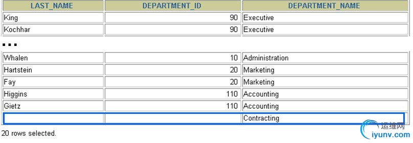

  20.右外联接
SELECTe.last_name, e.department_id, d.department_name
FROM   employees e
RIGHT OUTER JOINdepartments d
ON    (e.department_id = d.department_id) ;

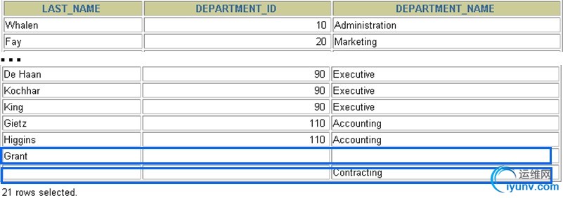

  21.满外联接
FROM   employees e
FULL OUTER JOINdepartments d
