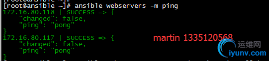

[iyunv@ansible ansible]# ansible-doc -s ping- name: Try to connect to host, verify a usable python and return `pong' on success.  action: ping
4.1ping模块  ansible webservers -m ping

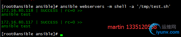

4.2 shell模块(需要执行客户机上的脚本可以用该模块,脚本在被控端)
[iyunv@ansible ansible]# ansible webservers -m shell -a '/tmp/test.sh'
说明:webservers是主机组的名称,-m  后面接的是模块名称,-a后是模块的参数

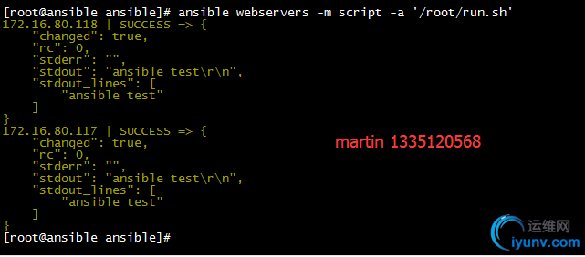

4.3script模块 (脚本在主控端)
[iyunv@ansible ansible]# ansible webservers -m script -a '/root/run.sh'

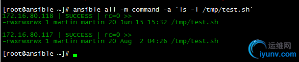

4.9 file模块
[iyunv@ansible ~]# ansible all -m file -a "dest=/tmp/test.sh mode=777 owner=martin group=martin"
