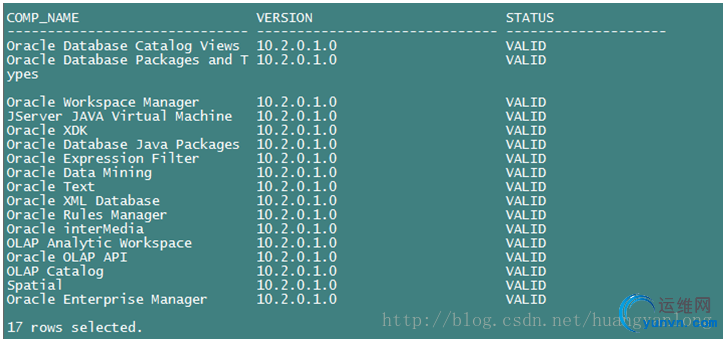

SQL> select comp_name,version,status from dba_registry;

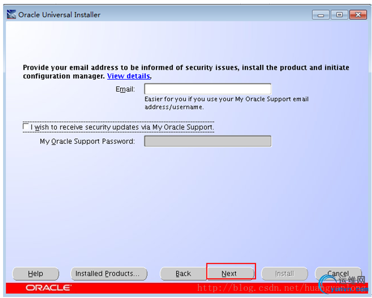

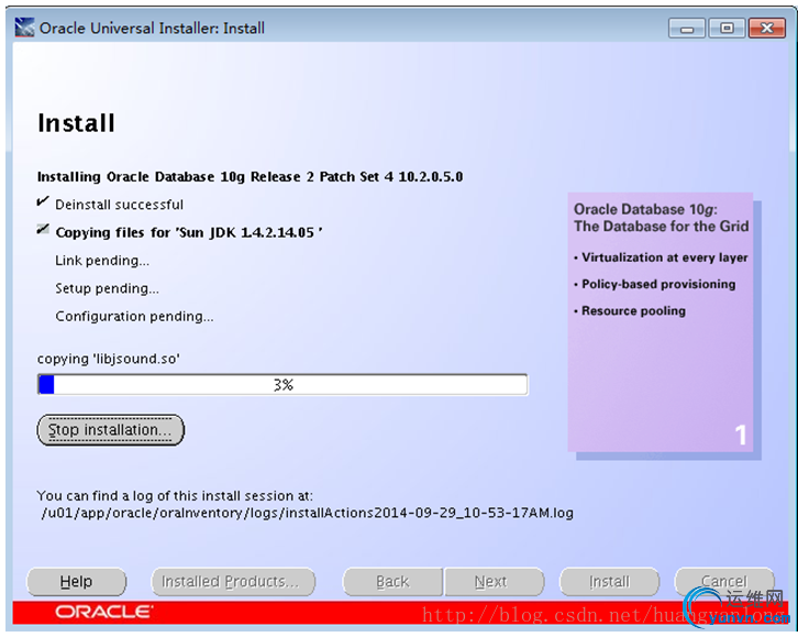

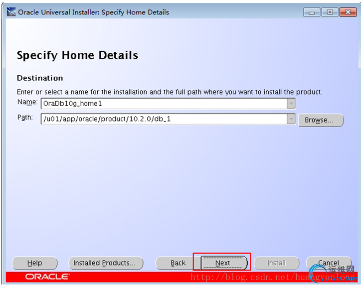

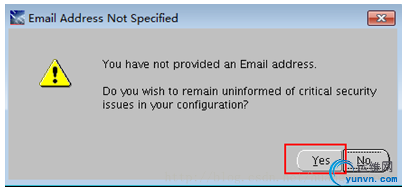

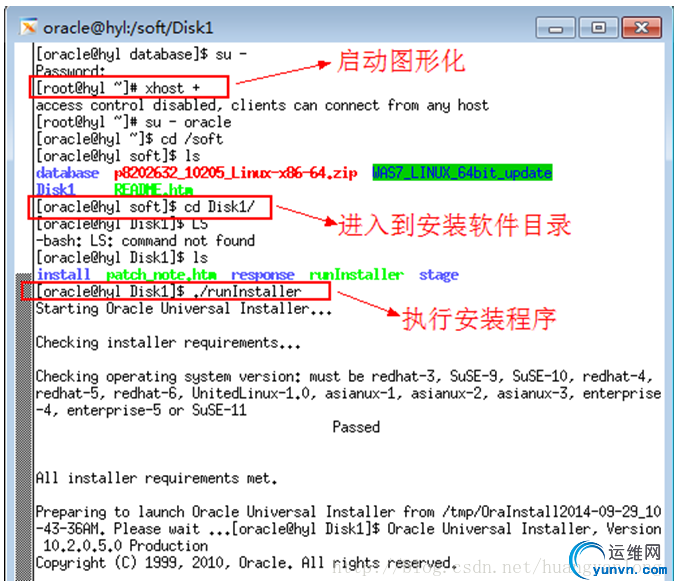

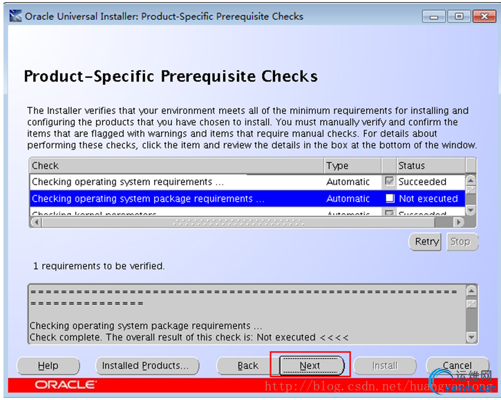

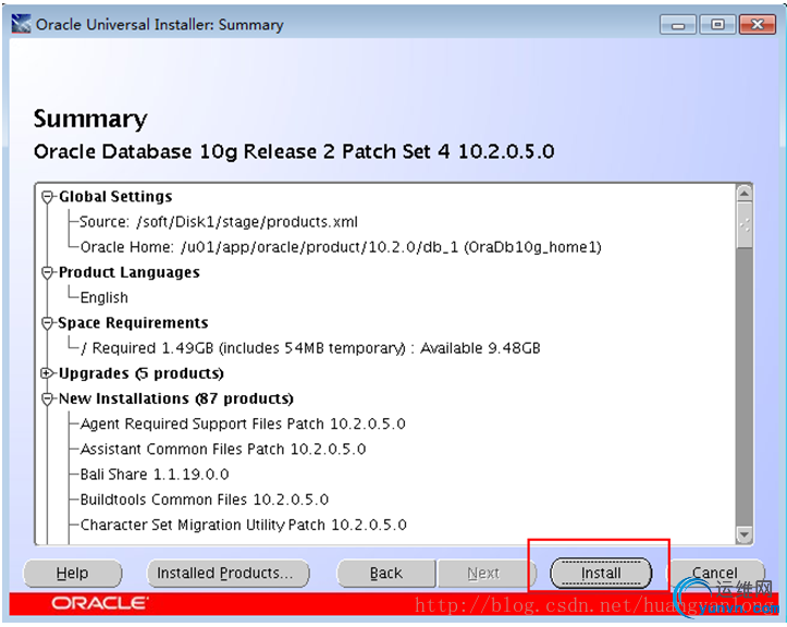

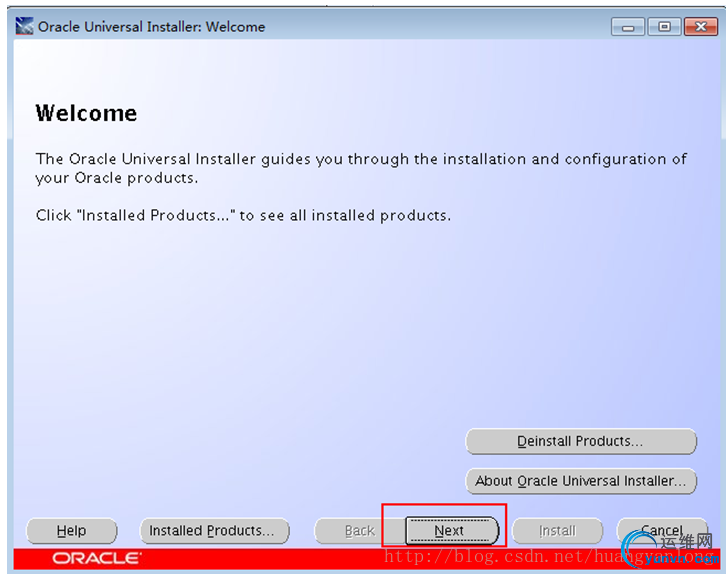

5. 升级oracle软件远程调用图形化界面,如下图例:

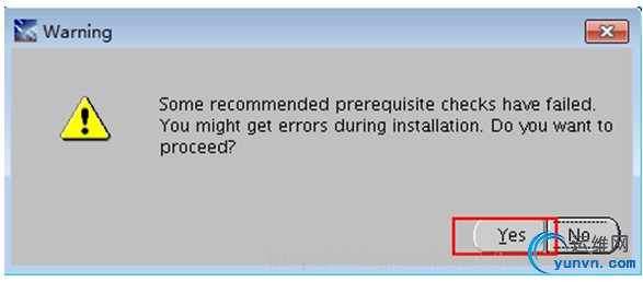

这里跳过需求包检查即可,点击yes继续,如下图:

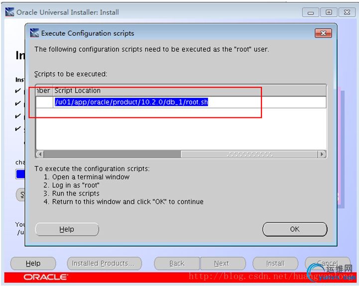

[iyunv@hyl ~]# /u01/app/oracle/product/10.2.0/db_1/root.sh
--按提示执行脚本
Running Oracle 10g root.sh script...
The following environment variables are set as:
    ORACLE_OWNER= oracle
    ORACLE_HOME=  /u01/app/oracle/product/10.2.0/db_1
Enter the full pathname of the local bin directory: [/usr/local/bin]:
The file "dbhome" already exists in /usr/local/bin.  Overwrite it? (y/n)
[n]: y
   Copying dbhome to /usr/local/bin ...
The file "oraenv" already exists in /usr/local/bin.  Overwrite it? (y/n)
[n]: y
   Copying oraenv to /usr/local/bin ...
The file "coraenv" already exists in /usr/local/bin.  Overwrite it? (y/n)
[n]: y
   Copying coraenv to /usr/local/bin ...
Entries will be added to the /etc/oratab file as needed by
Database Configuration Assistant when a database is created
Finished running generic part of root.sh script.
Now product-specific root actions will be performed.

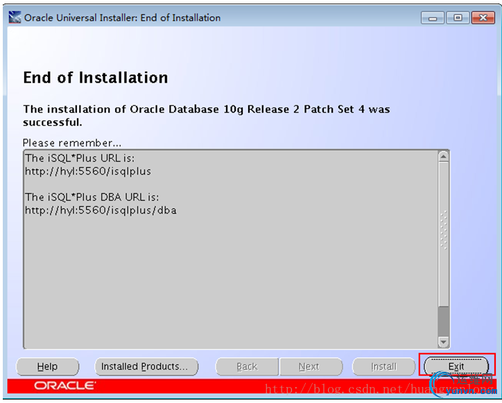

执行脚本后,点击界面ok,进入到结束界面,如下:

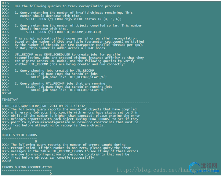

SQL> @?/rdbms/admin/utlrp.sql     --执行该脚本
SQL> select * from utl_recomp_errors;

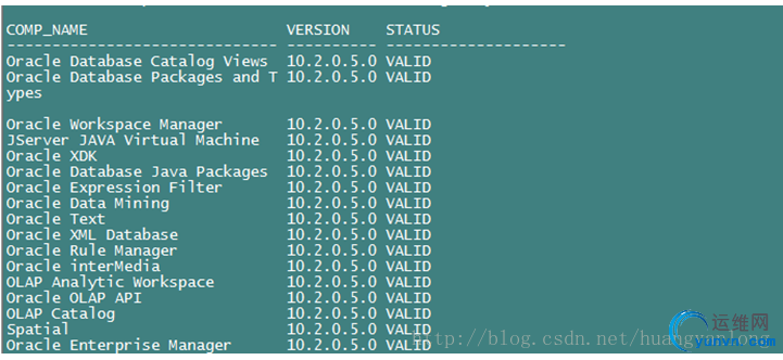

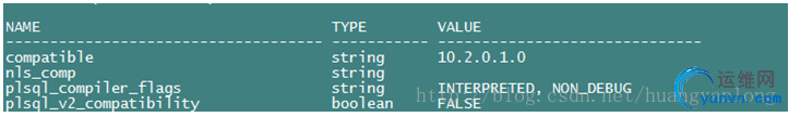

SQL> show parameter comp
修改兼容性
SQL> alter system set compatible='10.2.0.5.0' scope=spfile;

至此,数据库完成由10.2.0.1.0升级到10.2.0.5.0版本。
