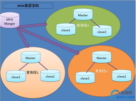

该软件由两部分组成:MHA Manager(管理节点)和MHA Node(数据节点)。MHA Manager可以单独部署在一台独立的机器上管理多个master-slave集群,
也可以部署在一台slave节点上。MHA Node运行在每台MySQL服务器上,MHA Manager会定时探测集群中的master节点,当master出现故障时,
它可以自动将最新数据的slave提升为新的master,然后将所有其他的slave重新指向新的master。整个故障转移过程对应用程序完全透明。

下图展示了如何通过MHA Manager管理多组主从复制。可以将MHA工作原理总结为如下

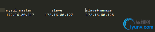

本次环境规划如下  (centos6.7)

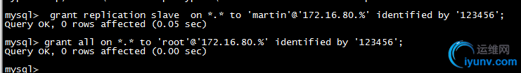

在3个mysql节点做授权配置
mysql>  grant replication slave  on *.* to 'martin'@'172.16.80.%' identified by '123456';
Query OK, 0 rows affected (0.05 sec)
mysql> grant all on *.* to 'root'@'172.16.80.%' identified by '123456';

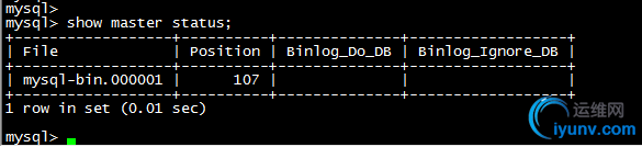

查看主节点上的日志状态mysql> show master status;
| File             | Position | Binlog_Do_DB | Binlog_Ignore_DB |
| mysql-bin.000001 |      107 |              |                  |
1 row in set (0.01 sec)

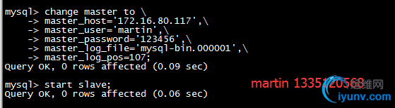

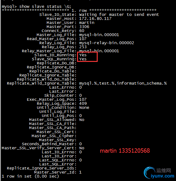

3、在两个从节点上面执行如下操作
change master to \
master_host='172.16.80.117',\
master_user='martin',\
master_password='123456',\
master_log_file='mysql-bin.000001',\
master_log_pos=107;

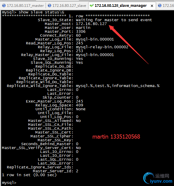

mysql> start slave;
Query OK, 0 rows affected (0.06 sec)
mysql> show slave status \G;   可以看到主从同步状态正常
9
10
11
12
13

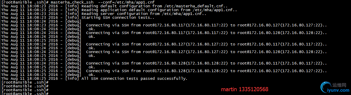

1、通过masterha_check_ssh验证ssh信任登录是否成功,
[iyunv@ansible scripts]# masterha_check_ssh  --conf=/etc/mha/app1.cnf
Thu Aug 11 19:29:03 2016 - [info] Reading default configuration from /etc/masterha_default.cnf..
Thu Aug 11 19:29:03 2016 - [info] Reading application default configuration from /etc/mha/app1.cnf..
Thu Aug 11 19:29:03 2016 - [info] Reading server configuration from /etc/mha/app1.cnf..
Thu Aug 11 19:29:03 2016 - [info] Starting SSH connection tests..
Thu Aug 11 19:29:04 2016 - [debug]
Thu Aug 11 19:29:03 2016 - [debug]  Connecting via SSH from root@172.16.80.117(172.16.80.117:22) to root@172.16.80.127(172.16.80.127:22)..
Thu Aug 11 19:29:03 2016 - [debug]   ok.
Thu Aug 11 19:29:03 2016 - [debug]  Connecting via SSH from root@172.16.80.117(172.16.80.117:22) to root@172.16.80.128(172.16.80.128:22)..
Thu Aug 11 19:29:04 2016 - [debug]   ok.
Thu Aug 11 19:29:03 2016 - [debug]  Connecting via SSH from root@172.16.80.127(172.16.80.127:22) to root@172.16.80.117(172.16.80.117:22)..
Thu Aug 11 19:29:04 2016 - [debug]  Connecting via SSH from root@172.16.80.127(172.16.80.127:22) to root@172.16.80.128(172.16.80.128:22)..
Thu Aug 11 19:29:04 2016 - [debug]  Connecting via SSH from root@172.16.80.128(172.16.80.128:22) to root@172.16.80.117(172.16.80.117:22)..
Thu Aug 11 19:29:04 2016 - [debug]  Connecting via SSH from root@172.16.80.128(172.16.80.128:22) to root@172.16.80.127(172.16.80.127:22)..
Thu Aug 11 19:29:04 2016 - [info] All SSH connection tests passed successfully.

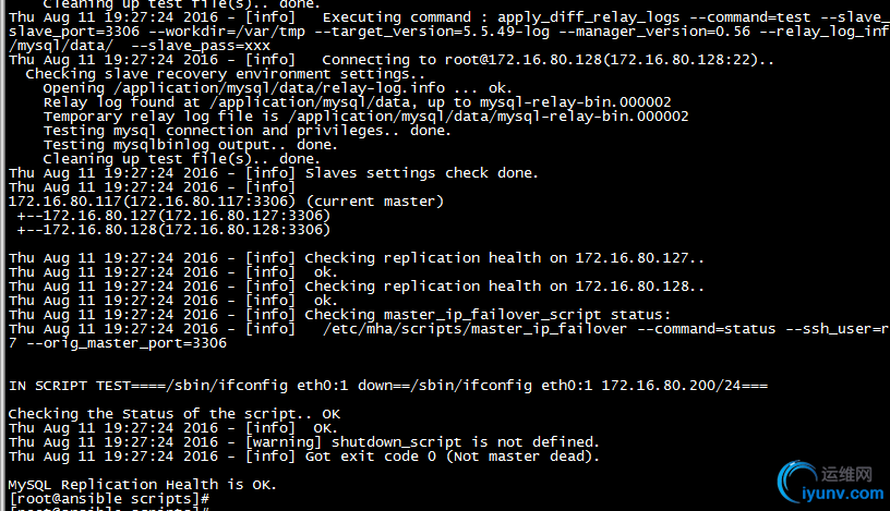

2、masterha_check_repl验证mysql复制是否成功
masterha_check_repl --conf=/etc/mha/app1.cnf
[iyunv@ansible scripts]# masterha_check_repl --conf=/etc/mha/app1.cnf
Thu Aug 11 19:31:53 2016 - [info] Reading default configuration from /etc/masterha_default.cnf..
Thu Aug 11 19:31:53 2016 - [info] Reading application default configuration from /etc/mha/app1.cnf..
Thu Aug 11 19:31:53 2016 - [info] Reading server configuration from /etc/mha/app1.cnf..
Thu Aug 11 19:31:53 2016 - [info] MHA::MasterMonitor version 0.56.
Thu Aug 11 19:31:54 2016 - [info] GTID failover mode = 0
Thu Aug 11 19:31:54 2016 - [info] Dead Servers:
Thu Aug 11 19:31:54 2016 - [info] Alive Servers:
Thu Aug 11 19:31:54 2016 - [info]   172.16.80.117(172.16.80.117:3306)
Thu Aug 11 19:31:54 2016 - [info]   172.16.80.127(172.16.80.127:3306)
Thu Aug 11 19:31:54 2016 - [info]   172.16.80.128(172.16.80.128:3306)
Thu Aug 11 19:31:54 2016 - [info] Alive Slaves:
Thu Aug 11 19:31:54 2016 - [info]   172.16.80.127(172.16.80.127:3306)  Version=5.5.49-log (oldest major version between slaves) log-bin:enabled
Thu Aug 11 19:31:54 2016 - [info]     Replicating from 172.16.80.117(172.16.80.117:3306)
Thu Aug 11 19:31:54 2016 - [info]     Primary candidate for the new Master (candidate_master is set)
Thu Aug 11 19:31:54 2016 - [info]   172.16.80.128(172.16.80.128:3306)  Version=5.5.49-log (oldest major version between slaves) log-bin:enabled
Thu Aug 11 19:31:54 2016 - [info]     Not candidate for the new Master (no_master is set)
Thu Aug 11 19:31:54 2016 - [info] Current Alive Master: 172.16.80.117(172.16.80.117:3306)
Thu Aug 11 19:31:54 2016 - [info] Checking slave configurations..
Thu Aug 11 19:31:54 2016 - [warning]  relay_log_purge=0 is not set on slave 172.16.80.127(172.16.80.127:3306).
Thu Aug 11 19:31:54 2016 - [warning]  relay_log_purge=0 is not set on slave 172.16.80.128(172.16.80.128:3306).
Thu Aug 11 19:31:54 2016 - [info] Checking replication filtering settings..
Thu Aug 11 19:31:54 2016 - [info]  binlog_do_db= , binlog_ignore_db=
Thu Aug 11 19:31:54 2016 - [info]  Replication filtering check ok.
Thu Aug 11 19:31:54 2016 - [info] GTID (with auto-pos) is not supported
Thu Aug 11 19:31:54 2016 - [info] Starting SSH connection tests..
Thu Aug 11 19:31:56 2016 - [info] All SSH connection tests passed successfully.
Thu Aug 11 19:31:56 2016 - [info] Checking MHA Node version..
Thu Aug 11 19:31:56 2016 - [info]  Version check ok.
Thu Aug 11 19:31:56 2016 - [info] Checking SSH publickey authentication settings on the current master..
Thu Aug 11 19:31:57 2016 - [info] HealthCheck: SSH to 172.16.80.117 is reachable.
Thu Aug 11 19:31:57 2016 - [info] Master MHA Node version is 0.56.
Thu Aug 11 19:31:57 2016 - [info] Checking recovery script configurations on 172.16.80.117(172.16.80.117:3306)..
Thu Aug 11 19:31:57 2016 - [info]   Executing command: save_binary_logs --command=test --start_pos=4 --binlog_dir=/application/mysql/data --output_file=/var/tmp/save_binary_logs_test --manager_version=0.56 --start_file=mysql-bin.000001
Thu Aug 11 19:31:57 2016 - [info]   Connecting to root@172.16.80.117(172.16.80.117:22)..
  Creating /var/tmp if not exists..    ok.
  Checking output directory is accessible or not..
   ok.
  Binlog found at /application/mysql/data, up to mysql-bin.000001
Thu Aug 11 19:31:57 2016 - [info] Binlog setting check done.
Thu Aug 11 19:31:57 2016 - [info] Checking SSH publickey authentication and checking recovery script configurations on all alive slave servers..
Thu Aug 11 19:31:57 2016 - [info]   Executing command : apply_diff_relay_logs --command=test --slave_user='root' --slave_host=172.16.80.127 --slave_ip=172.16.80.127 --slave_port=3306 --workdir=/var/tmp --target_version=5.5.49-log --manager_version=0.56 --relay_log_info=/application/mysql/data/relay-log.info  --relay_dir=/application/mysql/data/  --slave_pass=xxx
Thu Aug 11 19:31:57 2016 - [info]   Connecting to root@172.16.80.127(172.16.80.127:22)..
  Checking slave recovery environment settings..
    Opening /application/mysql/data/relay-log.info ... ok.
    Relay log found at /application/mysql/data, up to mysql-relay-bin.000002
    Temporary relay log file is /application/mysql/data/mysql-relay-bin.000002
    Testing mysql connection and privileges.. done.
    Testing mysqlbinlog output.. done.
    Cleaning up test file(s).. done.
Thu Aug 11 19:31:58 2016 - [info]   Executing command : apply_diff_relay_logs --command=test --slave_user='root' --slave_host=172.16.80.128 --slave_ip=172.16.80.128 --slave_port=3306 --workdir=/var/tmp --target_version=5.5.49-log --manager_version=0.56 --relay_log_info=/application/mysql/data/relay-log.info  --relay_dir=/application/mysql/data/  --slave_pass=xxx
Thu Aug 11 19:31:58 2016 - [info]   Connecting to root@172.16.80.128(172.16.80.128:22)..
Thu Aug 11 19:31:58 2016 - [info] Slaves settings check done.
172.16.80.117(172.16.80.117:3306) (current master)
+--172.16.80.127(172.16.80.127:3306)
+--172.16.80.128(172.16.80.128:3306)
Thu Aug 11 19:31:58 2016 - [info] Checking replication health on 172.16.80.127..
Thu Aug 11 19:31:58 2016 - [info]  ok.
Thu Aug 11 19:31:58 2016 - [info] Checking replication health on 172.16.80.128..
Thu Aug 11 19:31:58 2016 - [info] Checking master_ip_failover_script status:
Thu Aug 11 19:31:58 2016 - [info]   /etc/mha/scripts/master_ip_failover --command=status --ssh_user=root --orig_master_host=172.16.80.117 --orig_master_ip=172.16.80.117 --orig_master_port=3306
IN SCRIPT TEST====/sbin/ifconfig eth0:1 down==/sbin/ifconfig eth0:1 172.16.80.200/24===
Checking the Status of the script.. OK
Thu Aug 11 19:31:58 2016 - [info]  OK.
Thu Aug 11 19:31:58 2016 - [warning] shutdown_script is not defined.
Thu Aug 11 19:31:58 2016 - [info] Got exit code 0 (Not master dead).
MySQL Replication Health is OK.

模拟主库 172.16.80.117 数据库挂掉
[iyunv@centos02 .ssh]# /etc/init.d/mysqld stop
Shutting down MySQL................               [  OK  ]
可以看到这个从库自动连接到了新的主库 172.16.80.127上面
切换完成后,关注如下变化:
1、    vip自动从原来的master切换到新的master,同时,manager节点的监控进程自动退出。
2、    在日志目录(/var/log/masterha/app1)产生一个app1.failover.complete文件
3、    /etc/mha/app1.cnf配置文件中原来老的master配置被删除。
