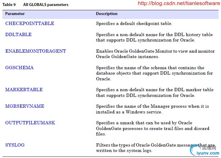

1.1 Overview of the GLOBALS file
  The GLOBALS filestores parameters that relate to the Oracle GoldenGate instance as a whole.This is in contrast to runtime parameters, which are coupled with a specificprocess such as Extract. The parameters in the GLOBALS file apply to allprocesses in the Oracle GoldenGate instance, but can be overridden by specificprocess parameters. Once set, GLOBALS parameters are rarely changed, and thereare far fewer of them than runtime parameters.
  --GLOBALS 文件里保存的参数争对整个GG instance,该参数可以被指定的进程参数覆盖,一般来说,GLOBALS参数一旦指定,很少修改。
  A GLOBALSparameter file is required only in certain circumstances and, when used, must becreated from the command shell before starting any Oracle GoldenGate processes,including GGSCI. The GGSCI program reads the GLOBALS file and passes theparameters to processes that need them.
  GLOBALS 参数文件仅当某些情况下才会使用,在使用时,必须在启动GG进程之前创建该参数文件。
  To create a GLOBALS file:
  1. From the Oracle GoldenGate installationlocation, run GGSCI and enter the following command, or open a file in an ASCIItext editor.
  EDIT PARAMS./GLOBALS
  NOTE:
  The ./ portionof this command must be used, because the GLOBALS file must
  reside at the root of the Oracle GoldenGateinstallation file.
  --在GG的根目录运行edit 命令创建参数文件,前面必须加./,因为GLOBALS文件必须放在GG 安装的根目录下面。
  2. In the file, enter the GLOBALSparameters, one per line.
  3. Save the file. If you used a texteditor, save the file as GLOBALS (uppercase, without a file extension) at theroot of the Oracle GoldenGate installation directory. If you created the filecorrectly in GGSCI, the file is saved that way automatically. Do not move thisfile.
  4. Exit GGSCI. You must start from a newGGSCI session before issuing commands or starting processes that reference theGLOBALS file.

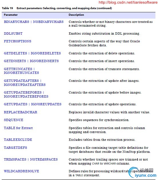

  (1)Global parameters apply to alldatabase objects that are specified in a parameter file. Some global parametersaffect process behavior, while others affect such things as memory utilizationand so forth.
  --global 参数影响所有参数文件中指定的databaseobject。 一些blobal 参数影响进程的行为,另一些影响内存使用等。
  USERID in Figure 4 and Figure 5 is an example of a global parameter.In most cases, a global parameter can appear anywhere in the file before theparameters that specify database objects, such as the TABLE and MAP statementsin Figure 4 and Figure 5.
  A global parameter should be listed only once in the file. Whenlisted more than once, only the last instance is active, and all other instancesare ignored.
  (2)Object-specific parametersenable you to apply different processing rules for different sets of databaseobjects.
  --object-specific 参数允许对不同的databaseobject 设置不同的process rule。
  GETINSERTS and IGNOREINSERTS in Figure 5 are examples ofobjectspecific parameters. Each precedes a MAP statement that specifies theobjects to be affected. Object-specific parameters take effect in the orderthat each one is listed in the file.

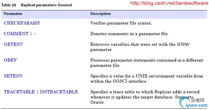

1.5 Verifying a parameter file
  You can checkthe syntax of parameters in an Extract or Replicat parameter file for accuracy.This feature is not available for other Oracle GoldenGate processes.
  可以通过参数验证Extrace 和Replicat 参数事都正确,该特性只对以上2组进程有效。
  To verify parameter syntax:
  1.Include the CHECKPARAMSparameter in the parameter file.
  --在参数文件里添加CHECKPARAMS 参数
  2. Start the associated process by issuingthe START EXTRACT or START REPLICAT command in GGSCI.
  START {EXTRACT |REPLICAT} <group name>
  Oracle GoldenGate audits the syntax and writes the results to the report file or tothe screen. Then the process stops.
  --然后启动进程,如果有错误,会将结果输出到screen,然后停止进程。
  3. Do either of the following:
  (1) If the syntax is correct, removethe CHECKPARAMS parameter before starting the process to process data.
   --如果正确,从参数文件中移除该参数。
  (2) If the syntax is wrong, correct itbased on the findings in the report. You can run another test to verify thechanges, if desired. Remove CHECKPARAMS before starting the process to processdata.
   --如果报错可以根据提示进行处理。

  (1)Wildcards
  (2)The OBEY parameter
  (3)Macros
  (4)Parameter substitution
Using wildcards
  For parametersthat accept object names, you can use an asterisk (*) wildcard to match any numberof characters. Owner names, if used, cannot be specified with wildcards. Theuse of wildcards reduces the work of specifying numerous object names or allobjects within a given schema.
  --可以使用*通配符来匹配对象。
  Using OBEY
  You can create alibrary of text files that contain frequently used parameter settings, and thenyou can call any of those files from the active parameter file by means of theOBEY parameter. The syntax for OBEY is:
  OBEY <filename>
  Where: <filename> is the relative or full path name of the file.
   --可以创建一个文件包含常用的参数设置,可以在active parameter 的情况下通过OBEY来调用其他的参数。

2.1 GLOBALS parameters
  The GLOBALS filestores parameters that relate to the Oracle GoldenGate instance as a whole, asopposed to runtime parameters for a specific process.

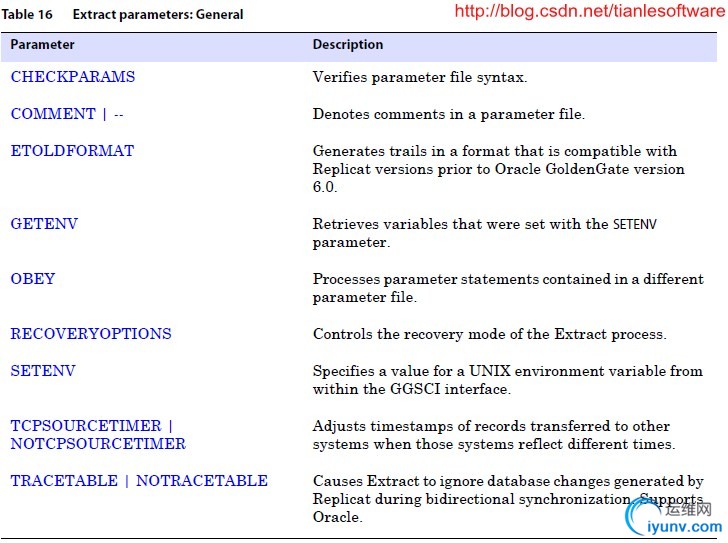

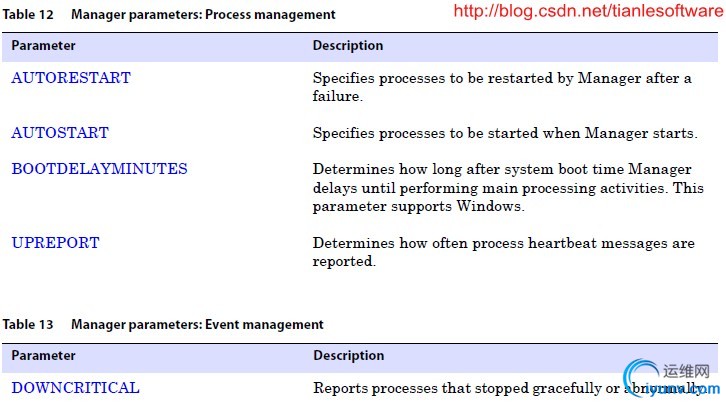

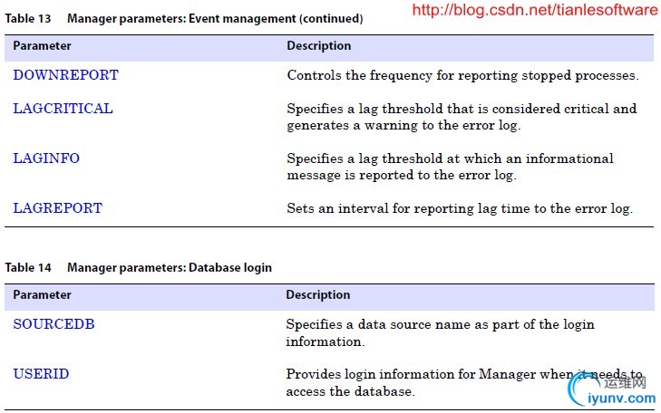

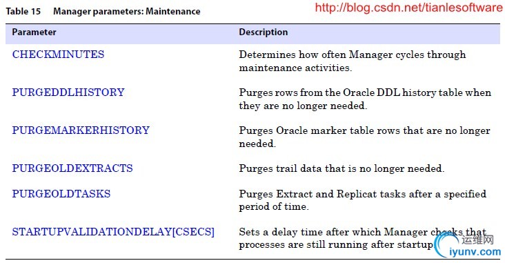

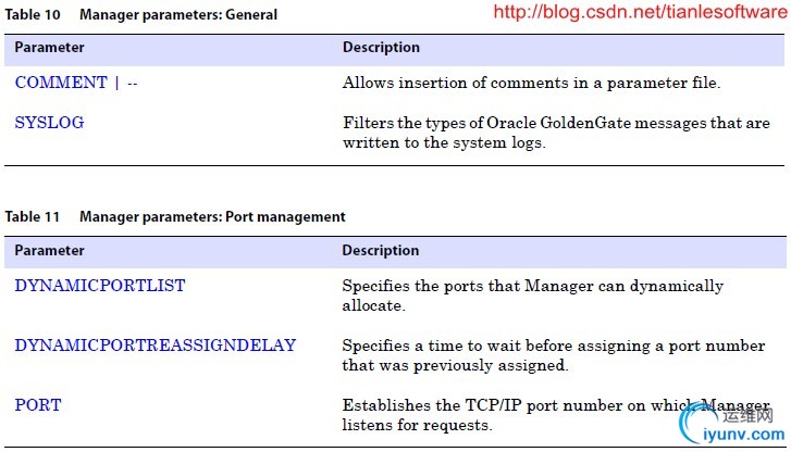

2.2 Manager parameters summary
  Manager is theparent process of Oracle GoldenGate and is responsible for the management ofits processes, resources, user interface, and the reporting of thresholds and errors.In most cases default settings for Manager suffice.
  --大多数情况下Manager 的默认参数是足够的。

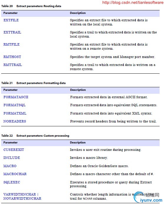

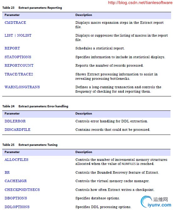

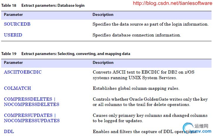

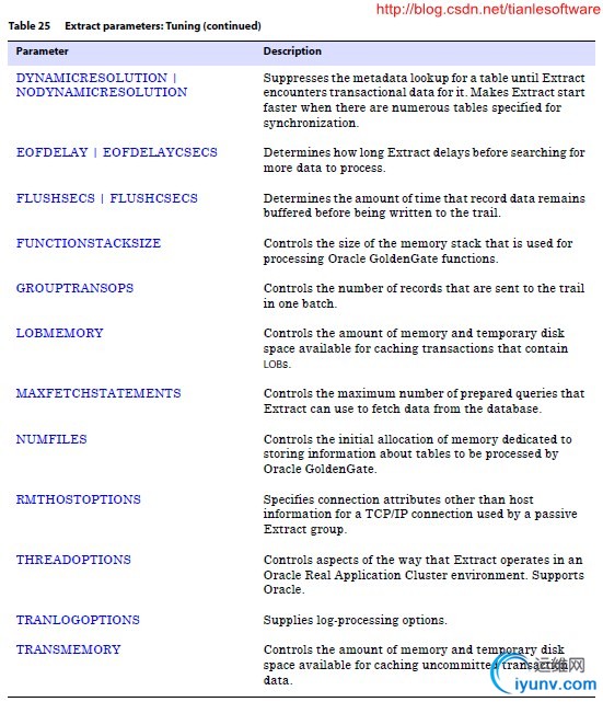

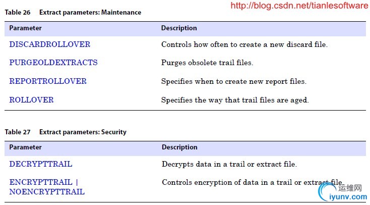

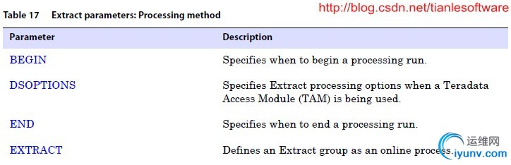

2.3 Extract parameters summary
  The Extractprocess captures either full data records or transactional data changes, dependingon configuration parameters, and then sends the data to a target system to be appliedto target tables or processed further by another process, such as a loadutility.

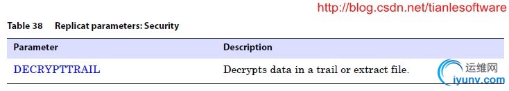

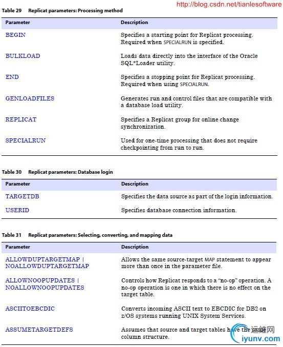

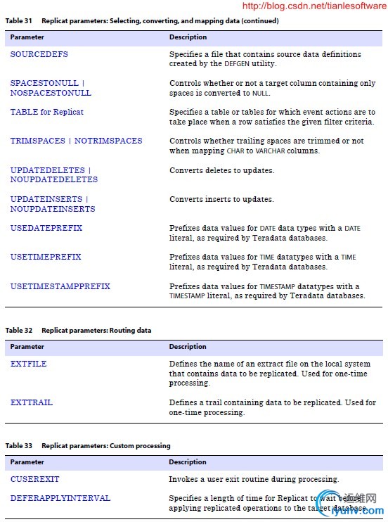

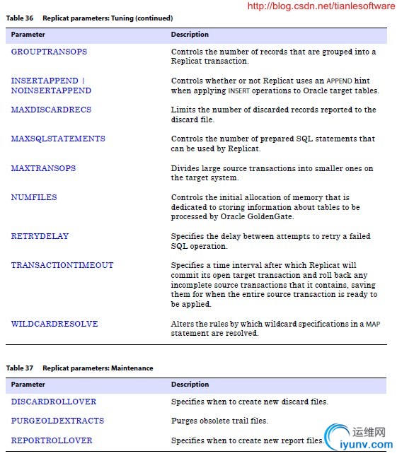

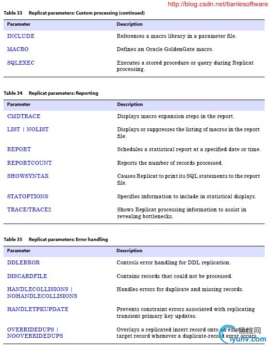

2.4 Replicat parameters summary
  The Replicatprocess reads data extracted by the Extract process and applies it to target tablesor prepares it for use by another application, such as a load utility.

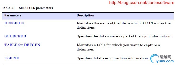

2.5 DEFGEN parameters summary
  DEFGEN creates afile with data definitions for source or target tables. Data definitions are neededwhen the source and target tables have different definitions or the databasesare of different types.

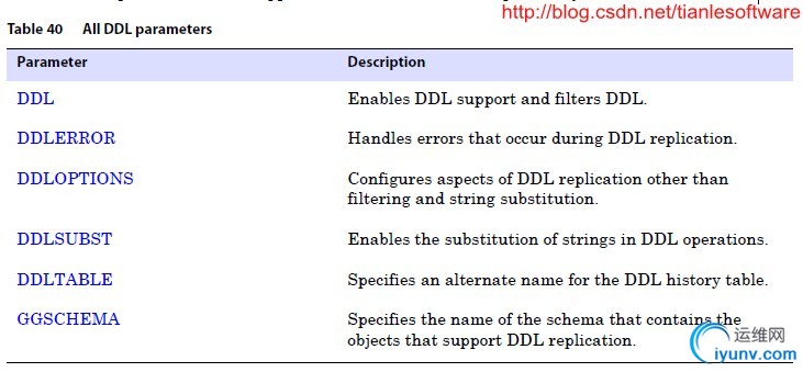

2.6 DDL parameters summary
  These parameterscontrol Oracle GoldenGate DDL support. Other parameters may be required withDDL support, but the ones here deal specifically with the DDL feature.
