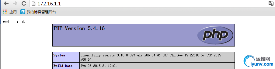

测试nginx和php的连接
[iyunv@luffy ~]# vim /data/www/index.php
[iyunv@luffy html]# systemctl reload php-fpm

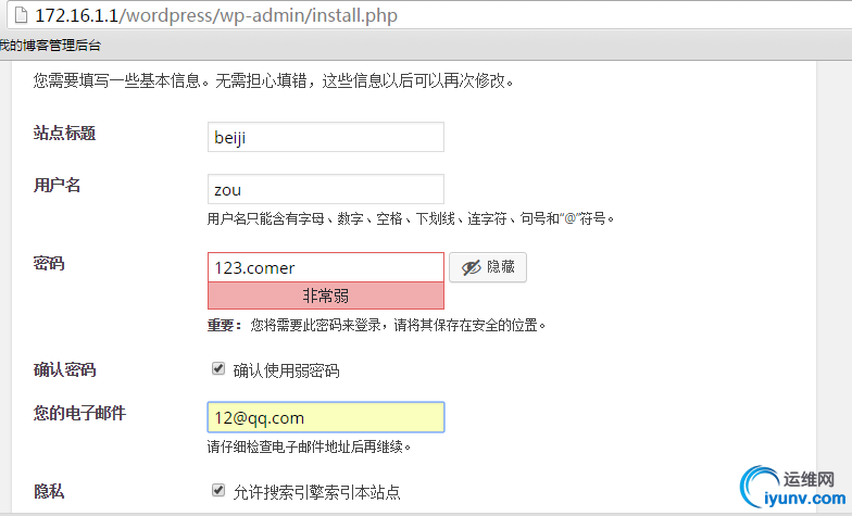

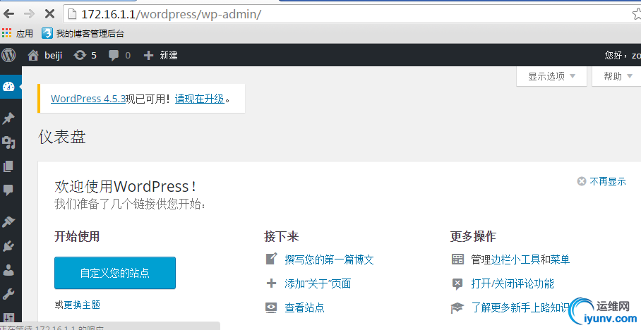

准备搭建wordpress了
把wordpress下载下来,并解压缩到/data/www目录下面
[iyunv@luffy wordpress]# pwd
/data/www/wordpress
[iyunv@luffy wordpress]# cp wp-config-sample.php wp-config.php
[iyunv@luffy wordpress]# vim wp-config.php
define('DB_NAME', 'wordpress');
define('DB_USER', 'wpuser');
define('DB_PASSWORD', 'wppasswd');
define('DB_HOST', 'localhost');
在浏览器键入:http://172.16.1.1/wordpress/
之后输入已经设定好的网页版的管理者zou和密码

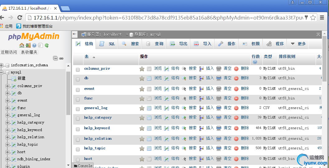

准备设置phpmyadmin
[iyunv@luffy phpmyadmin]# pwd
/data/www/phpmyadmin
[iyunv@luffy phpmyadmin]# vim libraries/config.default.php
$cfg['Servers'][$i]['host'] = 'localhost';
$cfg['Servers'][$i]['user'] = 'zou';
$cfg['Servers'][$i]['password'] = '123.comer';
[iyunv@luffy phpmyadmin]# yum install php-mbstring
[iyunv@luffy phpmyadmin]# nginx -s reload

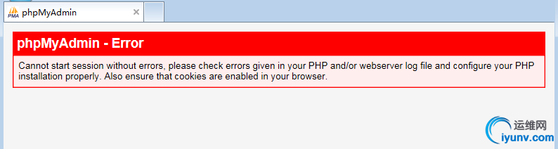

有错,php.ini的session问题
[iyunv@luffy php]# vim /etc/php.ini
session.use_cookies = 1
session.save_path = "/tmp"
在phpmyadmin中找到,config.sample.inc.php,改成config.inc.php,找到$cfg['blowfish_secret'] 将后面的赋值,加入数字和字母组合(最好位数在16位左右)
[iyunv@luffy php]# mkdir /var/lib/php/session
[iyunv@luffy php]# chmod 777 /var/lib/php/session/
[iyunv@luffy php]# nginx -s reload
[iyunv@luffy php]# systemctl reload php-fpm

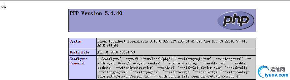

[iyunv@localhost php54]# mkdir -p /data/www
[iyunv@localhost php54]# vim /data/www/index.php
[iyunv@localhost php54]# iptables -F
[iyunv@localhost php54]# setenforce 0
[iyunv@localhost php54]# nginx -s reload
