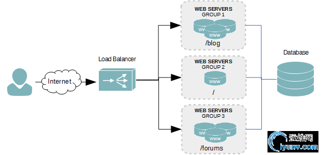

  tcp mode:
http mode

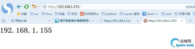

对后端upstream server进行动静分离:
    frontend webserver
    bind *:80
    acl url_static        path_beg        -i /static /images /javascript /stylesheets
    acl url_static        path_end        -i .gif .png .jpg .jpeg .js .html
    acl url_dynamic        path_end        -i .php
    use_backend static        if url_static or host_static
    use_backend dynamic        if url_dynamic
    default_backend        dynamic
backend static
    server node1 192.168.1.155:80 check maxconn 2000
backend dynamic
    server node2 192.168.1.11:80 check maxconn 2000

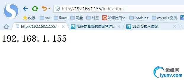

看效果图:默认后端为动态
带有index.html为静态
