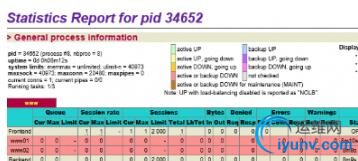

3.2.8 查看状态信息
检查备节点(192.168.1.82)http能正常访问
修改主节点(192.168.1.81)/application/haproxy/conf/haproxy.conf
vim /application/haproxy/conf/haproxy.conf
server www02 192.168.1.82:80 check
(wget 192.168.1.82能通但是浏览器中显示不正常,原因是走了健康检查了,将option httpchk HEAD /checkstatus.html HTTP/1.0注释掉)
/application/haproxy/bin/haproxy restart
此时查看浏览器上www02已经变绿
访问192.168.1.81(主节点)跟192.168.1.82(备)结果相同,表示四层负载均衡已经OK
