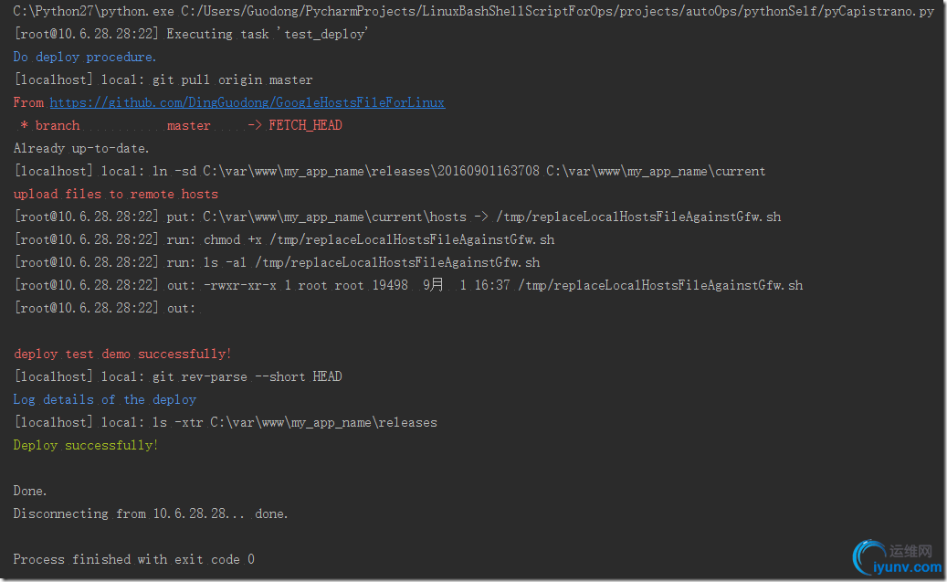

运行结果:

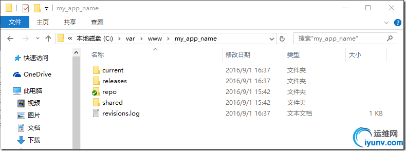

与Capistrano相同的目录结构:

脚本内容可以从GitHub上获取:https://github.com/DingGuodong/L ... elf/pyCapistrano.py

            def deploy(self):
                # TODO(Guodong Ding): core job here, this is a deploy demo
                with lcd(self.P.current_path()):
                    try:
                        src = os.path.join(self.P.repo_path(), "replaceLocalHostsFileAgainstGfw.sh")
                        local_path = os.path.join(self.P.current_path(), "hosts")
                        remote_path = "/tmp/replaceLocalHostsFileAgainstGfw.sh"
                        with open(src, 'r') as f:
                            content = f.read()
                        with open(local_path, "w") as f:
                            f.write(content)
                        if os.path.getsize(local_path):
                            print red("upload files to remote hosts")
                            put(local_path, remote_path)
                            run("chmod +x %s" % remote_path)
                            run("ls -al %s" % remote_path)
                            print red("deploy test demo successfully!")
                    except IOError:
                        raise NotImplementedError
            def run(self):
                print blue("Do deploy procedure.")
                self.P.makepaths()
                self.G.set(config["repo_url"], repo_path=self.P.repo_path())
                self.G.pull()
                self.P.make_release_dirs()
                self.P.make_current()
                self.deploy()
                self.P.update_revision_log(self.G.branch, self.G.short_id(), self.P.current, getpass.getuser())
                self.P.cleanup()
                print green("Deploy successfully!")
@roles("test")
def test_deploy():
    c = Capistrano.Application.Deploy()
    c.run()
def terminal_debug(defName):
    command = "fab -i c:\Users\Guodong\.ssh\exportedkey201310171355\
                -f %s \
                %s" % (__file__, defName)
    os.system(command)
    sys.exit(0)
if __name__ == '__main__':
    if len(sys.argv) == 1 and is_windows():
        terminal_debug("test_deploy")
    sys.argv[0] = re.sub(r'(-script\.pyw|\.exe)?$', '', sys.argv[0])
    print red("Please use 'fab -f %s'" % " ".join(str(x) for x in sys.argv[0:]))
    sys.exit(1)
