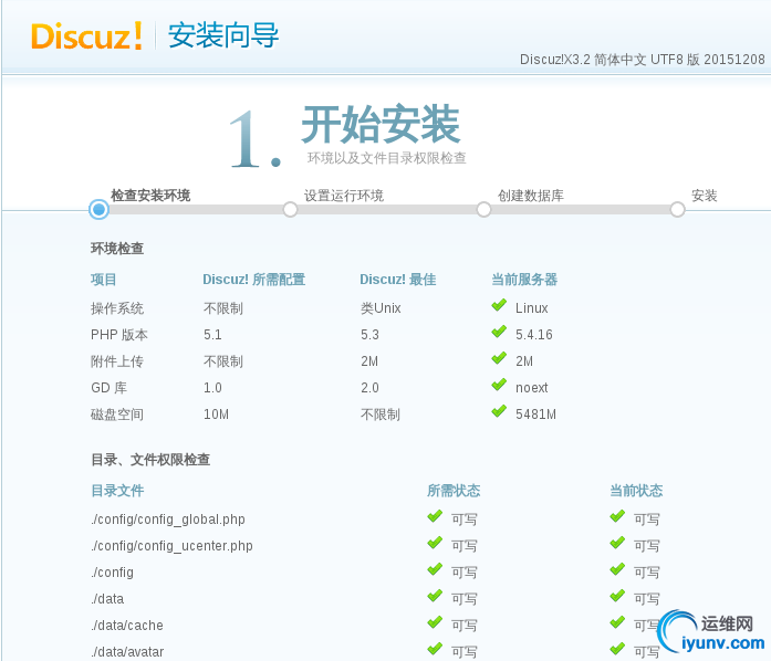

[iyunv@server1 bbs]# cd config/
[iyunv@server1 config]# cp -p config_ucenter_default.php config_ucenter.php
[iyunv@server1 config]# cp -p config_global_default.php config_global.php
[iyunv@server1 config]# chmod 777 -R  /var/www/html/bbs/

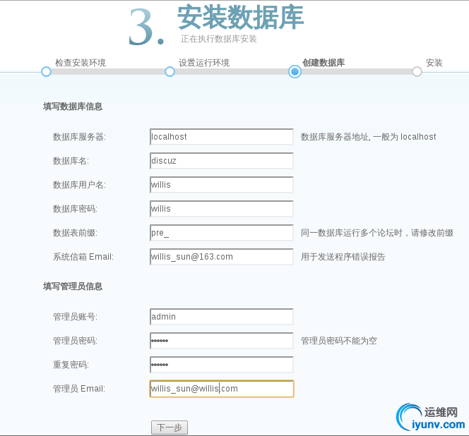

MariaDB [(none)]>  CREATE DATABASE discuz;         #新建数据库
Query OK, 1 row affected (0.00 sec)
MariaDB [(none)]>  CREATE USER willis@localhost identified by 'willis';   #新建用户
MariaDB [(none)]>  GRANT ALL on discuz.* to willis@localhost;      #用户授权
MariaDB [(none)]> quit
Bye
[iyunv@server1 config]# mysql -uwillis -pwillis    #测试新建的用户
Bye
[iyunv@server1 config]# systemctl restart httpd.service
[iyunv@server1 config]# systemctl restart mariadb.service
LAMP论坛搭建环境完成

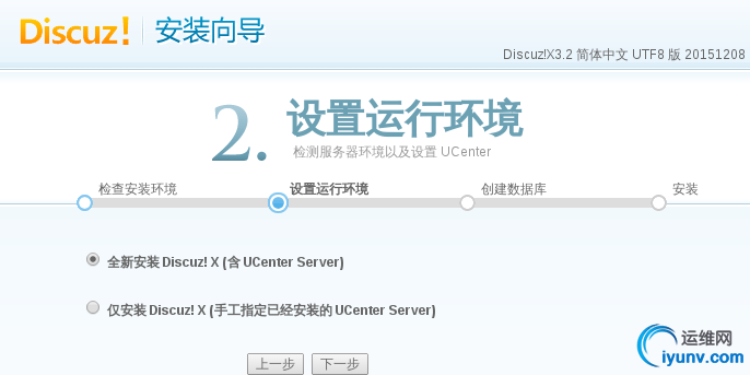

    5. 安装测试:
好了,安装完成,来看看什么样子吧。
