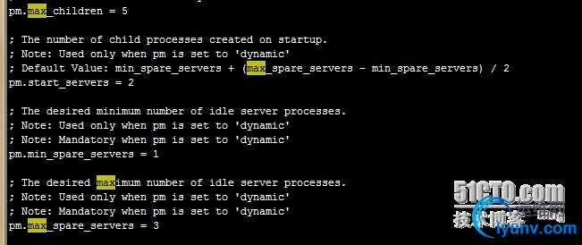

打开配置文件php-fpm.conf发现:pm.max_children = 5
修改成如下参数后,发现php日志中无此报警了:
; Note: This value is mandatory.
pm.max_children = 1024
