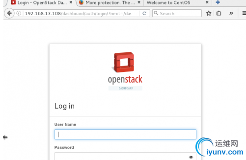

* To access the OpenStack Dashboard browse to http://192.168.13.108/dashboard .
Please, find your login credentials stored in the keystonerc_admin in your home directory.
