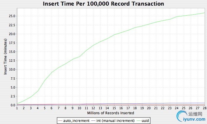

I wasn't sure how long I would have to wait for the expected results to show up, so, I started it up and forgot about it for a couple of days. When I came back here is what I found:
(how to read: it takes 20 minutes to insert 100,000 records into a UUID table which already contains 15 million records)
(how to read: it takes 25 hours to insert 15 million records into an empty UUID table)
Initial Thoughts
As you can see both the auto increment and manual increment tables grow pretty gracefully and the UUID table, ya, not so much. So what is going on here? My first guess was the implicit unique index on innodb_uuid's primary key was to blame, but I was not ableto say for sure that it simply was not the fact that the id field was bigger on innodb_uuid or that MySQL was configured poorly. So, first I changed the MySQL config a bit, increasing various buffers by a factor of 5 and rerunning for a while. What I foundis that increasing the buffers (specifically innodb_buffer_pool_size) did make a difference, but only for a brief period of time. Regardless of how much RAM you provide, this issue will rear its ugly head eventually. In order to narrow down the issue further,the previous experiment was ran with the addition of these tables:

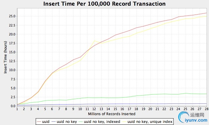

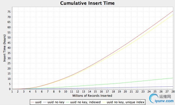

Experiment Run #2
This time around I decided to watch vmstat while the experiment was running. At first, everything was as expected, high IO wait due to heavy writing; however, after a few million records a trend started to appear: when records were being inserted into innodb_uuidthe high IO wait persisted but the heavy writing was replaced with very heavy reading and much lower writing. This read/write disparity grew with innodb_uuid's record count. Anyways, I allowed the second run to reach the same 28 million records as the first.The results for all UUID tables can be seen below:
Conclusion
As you can see innodb_uuid_no_key performs closely to its integer counterparts, innodb_uuid_no_key_indexed exhibits the same trend as innodb_uuid to a much less severe degree and innodb_uuid_no_key_unique_indexed is nearly identical to innodb_uuid. So the uniqueindex appears to be the issue here. But why? Well, given the above information, I'd say that MySQL is unable to buffer enough data to guarantee a value is unique and is therefore caused to perform a tremendous amount of reading for each insert to guaranteeuniqueness.
