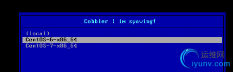

13、导入镜像
挂载centos光盘镜像
9
[iyunv@cobbler scripts]# mount /dev/cdrom /mnt
mount: block device /dev/sr0 is write-protected, mounting read-only
[iyunv@cobbler scripts]# df -h
Filesystem      Size  Used Avail Use% Mounted on
/dev/sda2        19G  1.6G   17G   9% /
tmpfs           491M     0  491M   0% /dev/shm
/dev/sda1       190M   33M  147M  19% /boot
/dev/sr0        3.7G  3.7G     0 100% /mnt
导入镜像
9
10
11
12
13
14
15
16
17
18
19
[iyunv@cobbler scripts]# cobbler import --path=/mnt/ --name=CentOS-6-x86_64 --arch=x86_64
task started: 2016-10-20_173717_import
task started (id=Media import, time=Thu Oct 20 17:37:17 2016)
Found a candidate signature: breed=redhat, version=rhel6
Found a matching signature: breed=redhat, version=rhel6
Adding distros from path /var/www/cobbler/ks_mirror/CentOS-6-x86_64:
creating new distro: CentOS-6-x86_64
trying symlink: /var/www/cobbler/ks_mirror/CentOS-6-x86_64 -> /var/www/cobbler/links/CentOS-6-x86_64
creating new profile: CentOS-6-x86_64
associating repos
checking for rsync repo(s)
checking for rhn repo(s)
checking for yum repo(s)
starting descent into /var/www/cobbler/ks_mirror/CentOS-6-x86_64 for CentOS-6-x86_64
processing repo at : /var/www/cobbler/ks_mirror/CentOS-6-x86_64
need to process repo/comps: /var/www/cobbler/ks_mirror/CentOS-6-x86_64
looking for /var/www/cobbler/ks_mirror/CentOS-6-x86_64/repodata/*comps*.xml
Keeping repodata as-is :/var/www/cobbler/ks_mirror/CentOS-6-x86_64/repodata
*** TASK COMPLETE ***
# --path 镜像路径
# --name 为安装源定义一个名字
# --arch 指定安装源是32位、64位、ia64, 目前支持的选项有: x86│x86_64│ia64
# 安装源的唯一标示就是根据name参数来定义,本例导入成功后,安装源的唯一标示就是:CentOS-6.6-x86_64,如果重复,系统会提示导入失败。
查看导入镜像

自定义ks.cfg文件
[iyunv@cobbler kickstarts]# cobbler profile edit --name=CentOS-6-x86_64 --kickstart=/var/lib/cobbler/kickstarts/CentOS-6-x86_64.cfg
修改内核参数
[iyunv@cobbler kickstarts]# cobbler profile edit --name=CentOS-6-x86_64 --kopts='net.ifnames=0 biosdevname=0'
查看所有的profile设置

15、修改这里,开机画面显示
[iyunv@cobbler kickstarts]# vim /etc/cobbler/pxe/pxedefault.template
DEFAULT menu
PROMPT 0
MENU TITLE Cobbler | im syaving!
TIMEOUT 200
TOTALTIMEOUT 6000
ONTIMEOUT $pxe_timeout_profile
QQ截图20161021081959.png 修改完毕后记着同步
[iyunv@cobbler kickstarts]# cobbler sync
