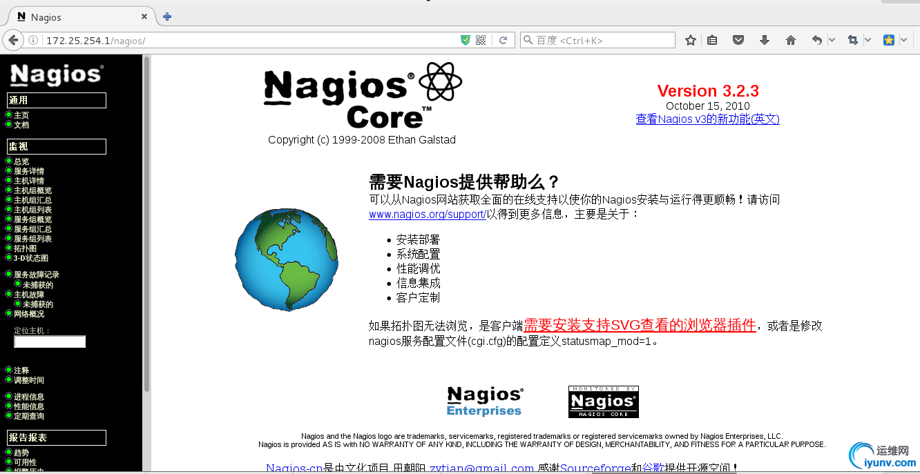

    (5)浏览器访问:172.25.254.6/nagios,用户为nagiosadmin,密码为自己刚改的密码。

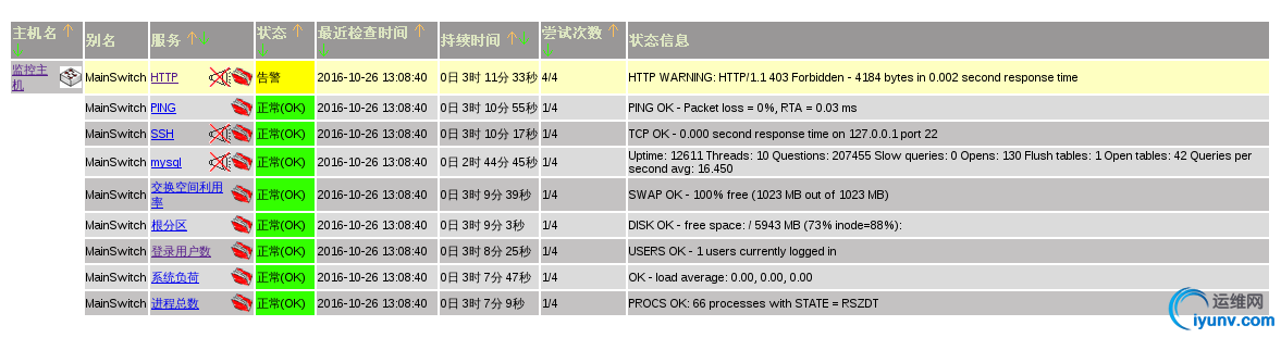

    (3.5)[iyunv@server1 objects]# /usr/local/nagios/bin/nagios -v /usr/local/nagios/etc/nagios.cfg
            ##检测有无错误
            Total Warnings: 0
            Total Errors:   0
            Things look okay - No serious problems were detected during the pre-flight check
    (3.6)
            [iyunv@server1 objects]# /etc/init.d/nagios reload
            Running configuration check...done.
            Reloading nagios configuration...done
           浏览器刷新浏览:172.25.254.1/nagios
3.加个mysql服务

        (4)浏览器刷新浏览:172.25.254.1/nagios
    可以看到多了一个Mysql监控
