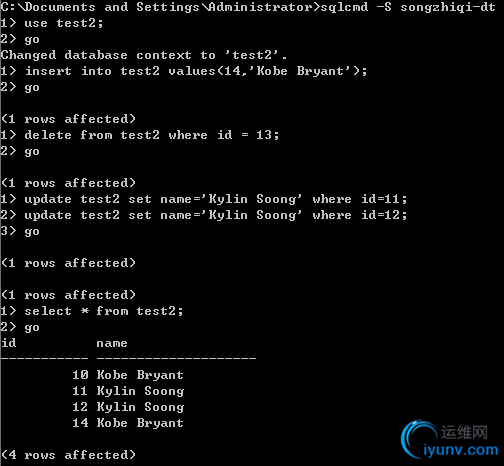

  Use sqlcmd to run Transact-sql
  the below figure show the process of the using of Transact-sql
 Note that: in the local server, there is a database name 'test2',and in database test2 exist a table named 'test2'.
